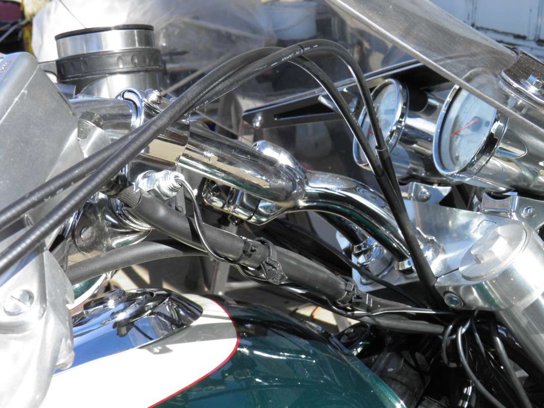

I have the same 6" Harley risers.  Brings the bars back and lets me rotate them down some to straighten my rists - helps with the carpal tunnel problem. I rerouted the cables, don't recall anything else.  I got the adapter bolts kit with the risers. This is on Jade - most comfy of my 4 Valks. You can ride it if we get some nice weather, Josh.
Not the best pic - I have a lot of stuff on the bars blocking their view.
