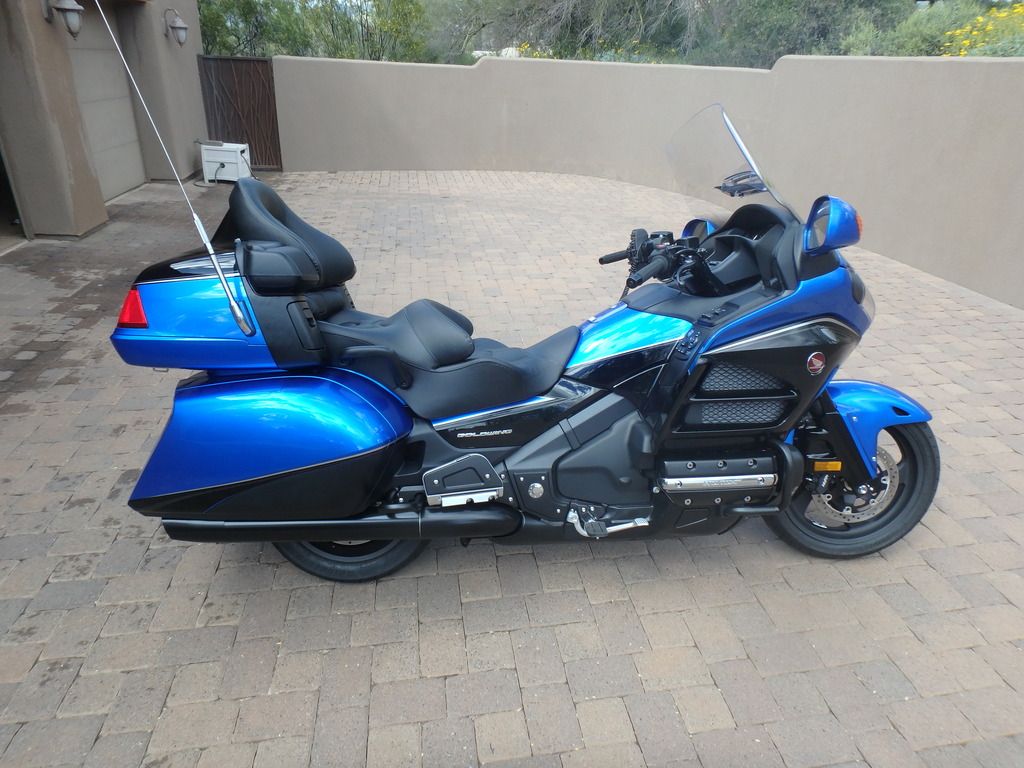

« Reply #12 on: March 23, 2017, 03:34:49 PM »
Well the Wing is finally fixed for good this time. It took a lot of money and time, but Western Honda is guaranteeing that ABS light will not come on in low temps. The only problem I have is the bike came back with some black stuff on the wheels and engine. When I got home I tried to clean it off, but I didn’t have any luck. I have posted a picture of the bike before I took in the last time and one when I pick it up today, so you can see what I’m talking about. If you have any ideas on what I could do to get rid of the black stuff I would appreciated. If not I guess I will have to live with it, but I’m just so happy I don’t have to deal with that flashing ABS light anymore.  cooldude

« Reply #13 on: March 23, 2017, 04:18:02 PM »
 2funny Looks sweet !!! I think you are going to have to live with that black stuff on your wheels. Congratulations  cooldude

« Reply #15 on: March 23, 2017, 09:42:36 PM »
They tried it but the new seat is a little longer and a little deeper. The holes line up but it didn't look good. I will be ordering another one. I have CB,fog lights,rear spoiler with brake light,black luggage rack,black belly pan,Handle bar risers,volt meter already on order thur the dealer. I'm also going to rebuild the front forks with Progressive Monotubes which also are on order. I still need to order baker wings , Black Mick o pegs and the Russell day long.  After that I should be done.

« Reply #17 on: March 24, 2017, 08:15:00 AM »
Nice looking Wing Ron. Should be easier to keep clean without all that chrome.  LOL
