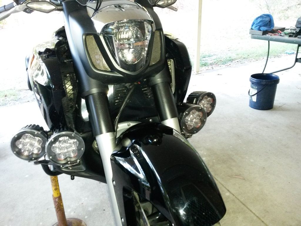

There is only one thing I like more then riding my bike and that is riding it in the dark.
The problem with that is bike lights are crap in general. The Valk's lights are pretty good as far as bike lights go but woeful is and understatement when banked over. I couldn't see into the tighter turns! I fixed that a while ago by adding 2 x 6000 lumen 60W 5 inch LED driving lights.
Not what most people would choose because of aesthetic reasons but I was more interested in what lurks in the shadows on country and mountain roads in the dead of night. These things have a 30 degree spread and I have a filter on them that gives me 60 degrees on the bottom LED's. This allows me to see drop bears raging out of the bush as well as 10 seconds plus down the road at the state speed limit. Perfect and drastically cheaper and in most cases more powerful then the bike specific brands.
I remember the first ride when I fitted the original 2. I was a little shocked at the wildlife I was blissfully unaware of. There is a lot of the buggers that could seriously put a crimp in a night ride.
Anyway why have 12000 lumens when you can have 24000 lumens? If I worked everything out there is power to spare. If not I am sure I will figure it out sooner or later but for the time being it is LOL.
Seriously I have laughed every time I have walked out and looked at it. I am laughing now and I don't care. I love this bike and it is a bonus when it puts a smile on my face, a bigger one if it makes me laugh.

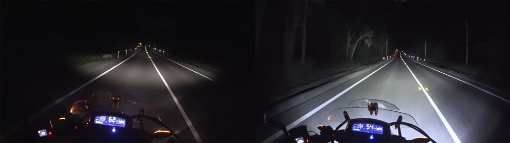

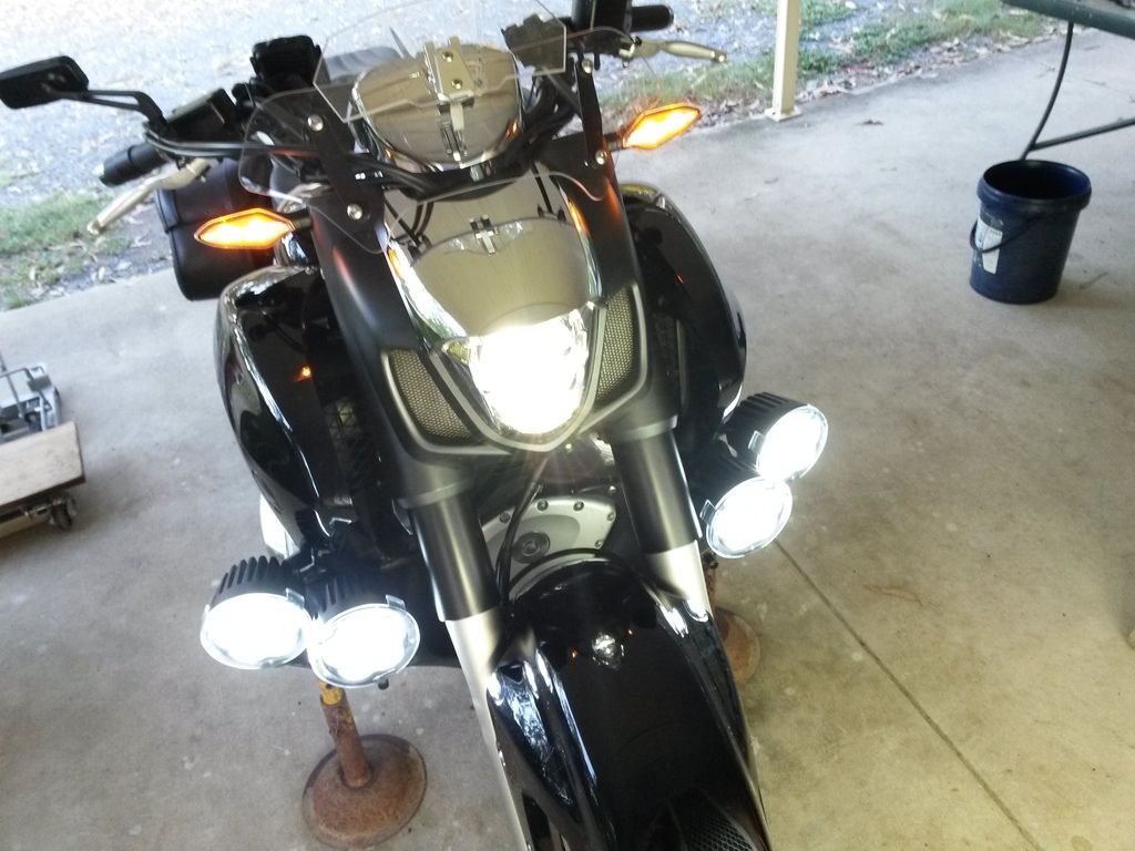

Behold the madness!
WTF
White spots in the eyes for a while!
On the left is standard high beam. Notice you can't even see the trees, no issues with the auxiliary lights on.
It is also amazing how fast oncoming traffic dip their lights. They think it is a bloody road train until I go by. Beep beep its a bike suckers Cheesy

That is excellent info thanks Kidd. I would need 2 of those suckers for the amp load I am running but that sounds like a plan and it would look awesome I think. No way could they be run in the day as they are as they are still blinding but with a dimmer that is now possible so thanks!
Unfortunately due to road laws here I am at the limit of how many I can put on. Pity... Plenty more room haha.

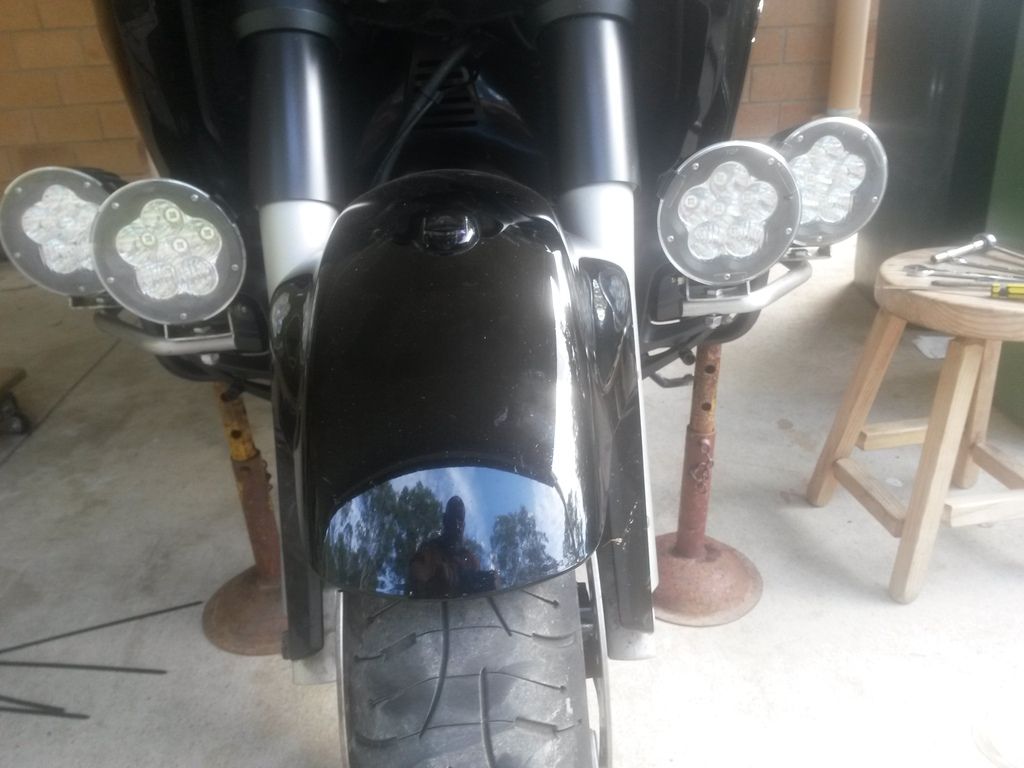

The Clearwater Erica's are the same lumins output as mine but 3.73 inch in size. They are $1113au + shipping to me... snort!
These things I am running are 5 inch BUT $115.59au delivered. I have been running the previous set since March 2016 and have found them to be good quality, tough and very reliable. Now that I have had time to think about it I am pretty sure I have checked that dimmer circuit out before and I don't think these are dimmable.
But for 1/10th the price... so no brainer.
Also another factor that I had to account for was spread.  Far reaching vision is important at night but what is of equal importance to me is what is on the side of the road, actually that is more important than what is 10 seconds down the road. These things I am using have a 30 degree spread and with the lens covers give a 60 degree spread. I had a hard time finding that with bike specific lights. Actually at the time I couldn't find any. Most had 10 which is basically useless for me.
Even with the 60 degree spread I have opted for a second set and have angled them out slightly for more spread and also to help when banked over. I can see into corners in pitch black which could be considered a bonus Wink
This are the actual ones I am using...
http://www.ebay.com.au/itm/2X-5-INCH-60W-CREE-LED-Light-Spot-Combo-Beam-Offroad-ATV-SUV-FORD-RPLACE-HID-9-/111929311179?hash=item1a0f81bfcb:g:CpcAAOSw44BYW4PT
They were initially a function over style addition but to be honest I really like the look of it now. I am all set for the zombie apocalypse!

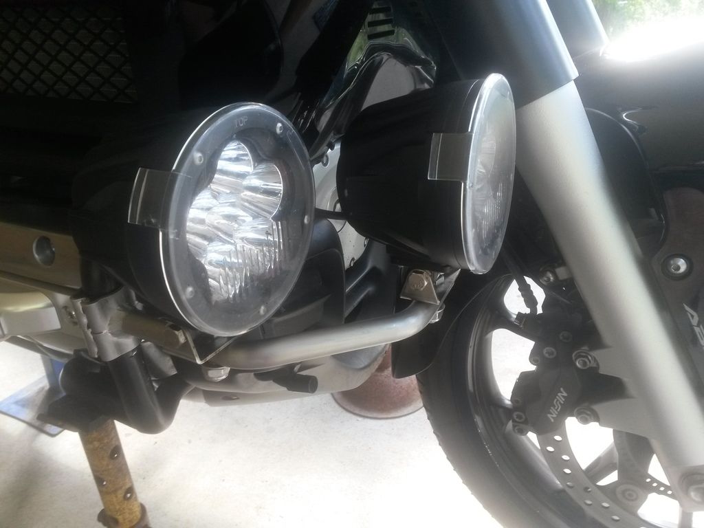

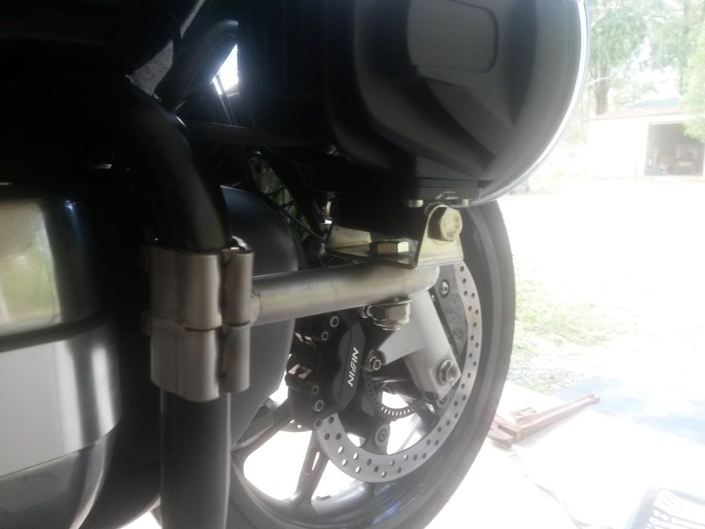

« Reply #24 on: June 01, 2017, 01:22:45 PM »
Kidd, I haven't been here for a bit and just noticed your crazy lights and mountings. Outstanding  coolsmiley
I mate of mine fabricated me some custom mounts. They are made out of solid stainless steel rods and brackets and they are now the strongest part of the bike. I am very happy with the look of them as well. Can't wait for the zombie apocalypse.
