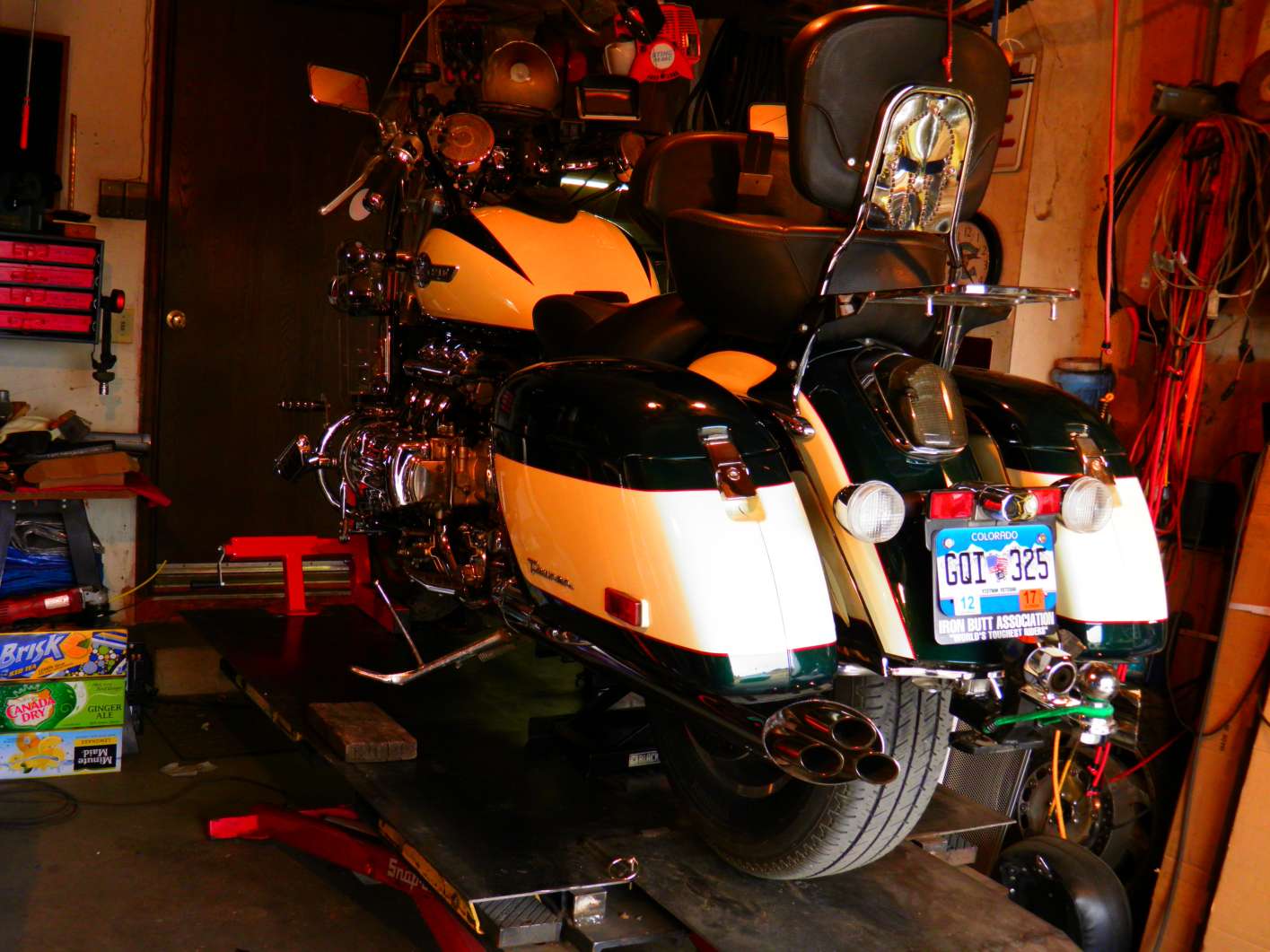

« Reply #4 on: March 25, 2017, 09:25:15 AM »
I did like Mike and it's pretty quiet
Except I made my own extensions
« Last Edit: March 25, 2017, 09:30:52 AM by Chrisj CMA » Logged

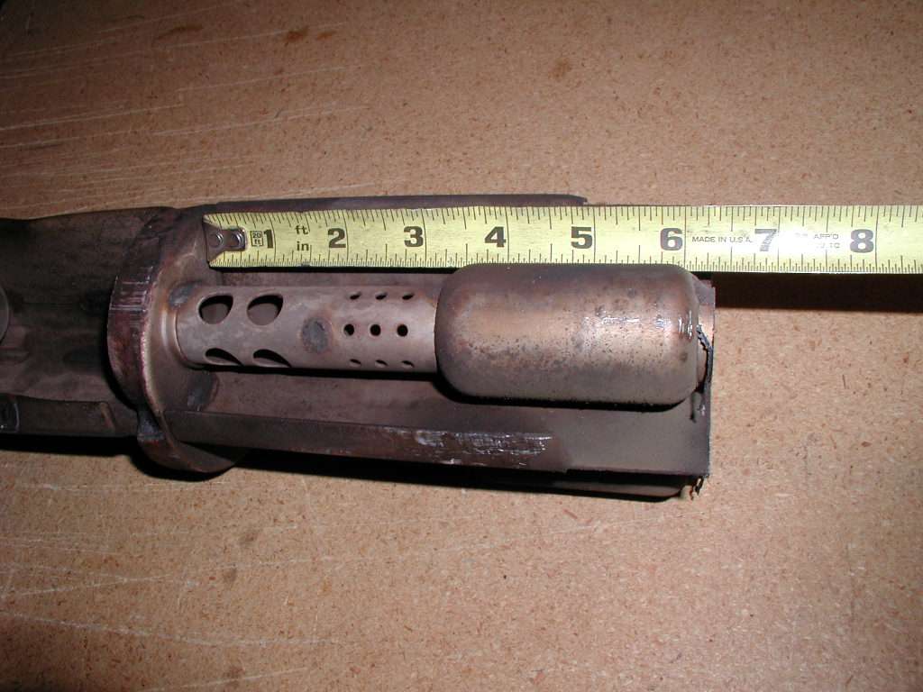

« Reply #7 on: March 25, 2017, 03:19:38 PM »
Here's a inside look at the exhaust;
http://www.valkyrieriders.com/shoptalk/GL1/gl45.jpg

The droning. That is why I extended the piggies. No more drone
How did you extend them?
3/4" copper pipe front Lowes ten bucks or so
« Last Edit: March 26, 2017, 01:16:38 PM by Chrisj CMA » Logged

Update from the OP.  I just looked inside the rear end of the exhaust and all 3 of the little pipes have been cut off about 1-1/2" from the exit from the muffler proper.  In other words they look to be about 6-8" shorter than stock.  I bet this is one of the reasons why the bike seems too loud and resonant at low rpm.
When I bought the bike it had a Cobra exhaust.  I bet the previous owner tried to make it louder by cutting off the little pipes and decided that wasn't loud enough so he put on the Cobras.
It looks like I might be able to use a method similar to above to add sections of copper pipe to try and recreate the original acoustic property of the stock exhaust.
I knew something sounded different than my previous Valkyrie.

I started out like Chris by extending 3/4" copper pipe beyond the tips, and it seemed almost whisper quiet (slight exaggeration) compared to stock, and ran that for a year.
Then I bought truck stacks with Grumpy's tips and changed the 3/4" piggies to 1" (because I'm a tinkerer and can never leave anything well enough alone) but ended them about 4" from the end of the tips.  Absolutely loved the sound, it was much deeper and had a nice growl to it,  but the droning was too loud with the face shield pulled down on my 3/4 helmet.  Ran that for a year.
My latest iteration is to step the 1" pipe up to 1 1/4" and extend it nearly all the way out, not past the tips as I don't care for the look of the piggies extending beyond the tips.  Haven't had it out of the garage yet but have high hopes.
That said, Hubcap and Chris's method, provided you have unmucked stock pipes should get you what your looking for.
That looks awesome with the three 1 1/4 inch pipes.  I may have to try that on Bruce's bike.  It already has trick stack tips and grumpy's tips.

OP again.  Here is what I found when I pulled off the outer cover.
Although I couldn't get a picture, when I look up inside the cut off pipes I see a flat plate about 1" up inside the muffler.  In other words it doesn't look like anybody took a drill to the interior muffler baffle.  I'm going to get some soft copper pipe tomorrow and try to recreate the other users system where the pipes stick out of the ends a couple inches.  Sure hope this works.  I'm hopeful but it's hard to understand how extending the little pipes 6" can change the sound volume.  Nothing to lose, so I'm going to try it with my fingers crossed.

« Reply #24 on: March 26, 2017, 12:34:47 PM »
Yep, that is a drone maker like that
In the pic below (courtesy MarkT's horseapple.com web site) the ends of your piggies would be at about 8" on the tape measure.  If you look at about 1 3/4" you will see a spot weld on the pipe; this is where the rear internal baffle is welded inside the pipe, and is what is drilled out by those who want a little more sound.  As you can see, it is about 4 1/2" inside the muffler can (quite a bit deeper than the 1" you indicate), or about 6 1/2" from the ends of your piggies.

https://sites.google.com/site/valkexhuast/valk-ex/39554.jpeg?attredirects=0This is my exhaust that is to much for my ears any ideas
Remember, if they can't find you handsome at least  they can find you handy!
