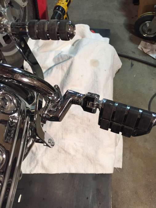

These are Kuryakyn 4029 Offset Highway Pegs.  http://www.kuryakyn.com/products/4029/offset-highway-pegs
Works great with fwd controls.  Very adjustable, doesn't move when set. Recall the rt crashbar is fwd of the left, and position of pegs matters a lot with fwd cntrls.  Easy to get there with these.

Notice that with the offsets turned in on themselves as they are, all they are providing in movement is a wider foot position, about a 2.5" addition straight to the mount point on the engine guard (not counting the clevis).  None of the circular mounting possibilities are being used (because it's not needed), but for longer legs it could be needed.
Mine just have the clevis bolted straight to the clamp (lips aimed to the rear like Mark's).  His pegs are centered on the guards, mine are a bit shorter mounted straight to the clamp lips.  I could add a little reach length just by turning the clamp lips around forward with the clevis ahead of the guards.  It's just a question of leg length.  My reach is far enough just to my pegs straight on the engine guards (and this is farther than the reach to my 4050s adjusted right up to the guards on my other bike).

Like Mark has in the picture, guard mounted hwy pegs need to be angled back toward the rider, more or less, depending on leg length.  Bolting them on for the first time, it might be intuitive to mount them straight and level for best appearance.  But human legs form a Y not an H, so they need to go on crooked to put your feet on comfortably.  And getting both sides equally crooked is harder than you'd think.

The advantage to me for these offset pegs is they are versatile - the 360° rotation allows for different leg lengths as well as height w/o changing the angle of the footpeg (can mount in center of crashbar, or up/down if you want cant).  Not to mention reach length - fwd or back of the bar as Jess mentioned.  Mine happened to work out well for me straight w/o much adjustment, though left is turned down some and rt is nearly level. But I did fiddle with that for awhile, getting them to position well with the controls as well as comfy on my leg length.  BTW I have 31" inseam, Russell Daylong seat.
I have Deerslayer set up the same, with fwd cntrls. I used the offsets rotation adjustments much more because the Ultimate Big Boy seat sits differently.
I occasionally bump the hot valve cover - not often and not an issue.  Just pretty warm, doesn't burn skin (with jeans).
