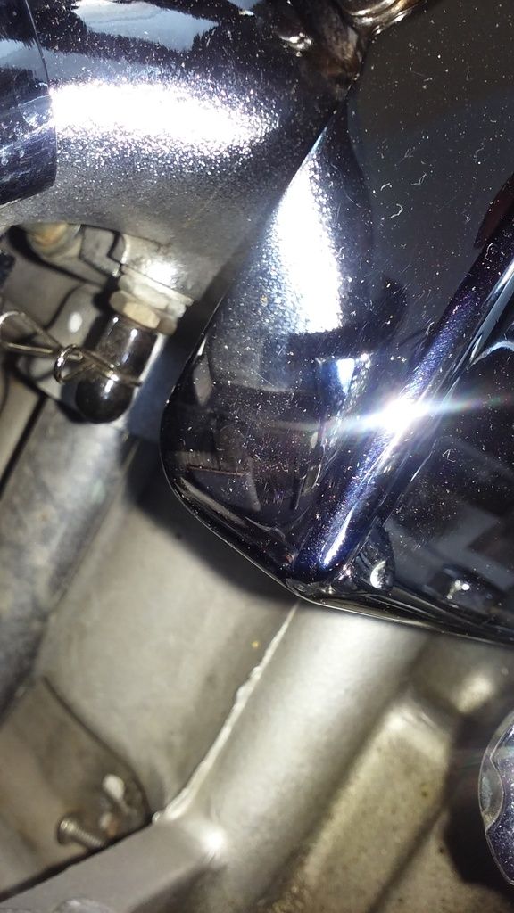

« Reply #15 on: April 21, 2017, 09:03:49 AM »
Zip ties?
We done need no steenkin zip ties!
Big BF did this back in August to five new caps. Does this remove the caps as a possible problem???
« Last Edit: April 21, 2017, 09:07:31 AM by Britman » Logged
Posts: 31104
« Reply #16 on: April 21, 2017, 09:38:10 AM »
Maybe, if you carefully check each one for rips or tears.  Those look like run of the mill auto parts vacuum caps (though I would not change them if they are holding up OK).
Just because the clamps are in place, does not mean a cap is not leaking (maybe on the side away from your visual inspection).  My bad ones all had small zip ties on them (job done by Big Bill too).
Based on your backfire being identical to mine (hard decell, loud bang), I was pretty sure this was the culprit.
I was thinking there might be another way to check.  Wearing a led headband light, get a good cigar going, start the bike, and blow a little smoke down on each nipple (but you'll need to rev the bike some too), to see if the smoke is just wafting, or being blown around by something like a leak (maybe bending the caps to and fro a bit too - burned fingers).
I suppose it could be the #6 going to the petcock too (if you still have that).
If this is not the problem, I punt.
« Last Edit: April 21, 2017, 09:46:34 AM by Jess from VA » Logged
