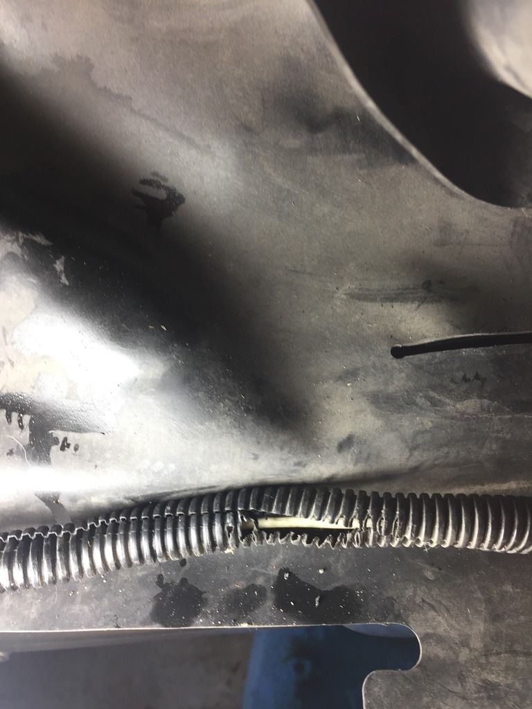

Found my problems this evening.
Stupid electrician had run a cross over wire for his running lights below the radiator. They got pushed up by some triple digit riding into the fan area. Pulled and tested the fan and it runs fine.
