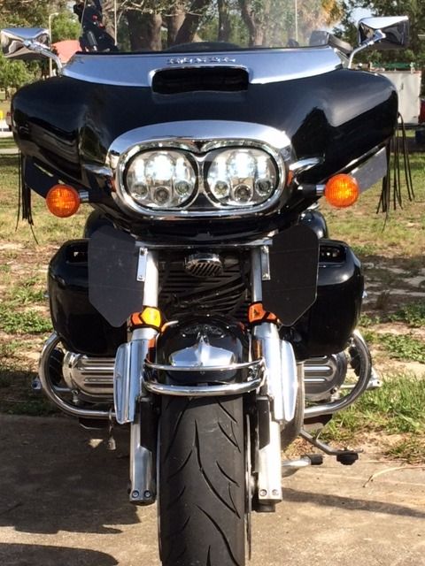

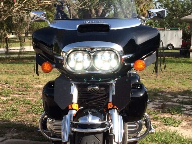

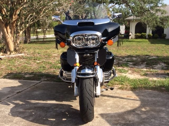

 They are "BRIGHT"  Cool Cool Cool

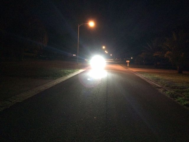

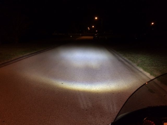

night pics don't do them justice, I had a few drivers flick their high beams at me. I lowered the low beams to about 30' out
low beam
high beam

I will try to post pics to convert the lights. I have all the pics from step one to final assembly.
A quick run down of the steps, and by no means the instructions.  Its a bit complicated to fabricate the brackets that hold the Road Glide head light assembly. It took me a couple of weeks of trial and error and many prototypes made out of Cardboard and crazy glue to stiffen it up. The final brackets are aluminium. You have to separate the lens from the interstate assembly. Remove the reflectors. You will have to trim some of the fins on the back side of the H/D lights, to get the brackets to sit flush and level. Install the old hardware from the I/S reflectors to the new brackets and fasten down using lock nuts. After all pre installation is done, then you will remove the clear lens from the H/D lights to keep any fingerprints or smudges to a minimum. Reinstall the lens to the I/S light assembly.
These are not the instructions but some of the steps I went thru to make them fit and be adjustable too.
I would suggest purchasing a spare I/S light assembly so you can take your time and unwind any frustrations you will develop.
low beam
high beam

WOW !  Great pics
That just may be enough that even I could probably see at night
How many feet ahead do low and high do the job?

Oss, I have the low beams at 30' out and the high beams about 100' out.
