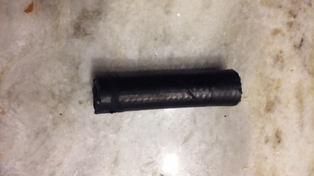

« Reply #13 on: June 08, 2017, 03:01:34 AM »
the fatter line to the right
Posts: 16820
« Reply #14 on: June 08, 2017, 03:28:35 AM »
Hmmm... that seems like it ought to be 17701-MZ0-000 ... maybe

« Reply #16 on: June 08, 2017, 07:08:11 AM »
Here's the fat hose
Nearly 2inches long. other end goes to a fuel filter.
