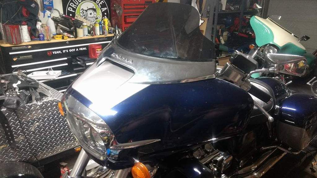

I seen an Interstate for sale on Ebay that had this shield on it, I also seen Vance and Jerry posting on the 1500 board about this shield so since I liked the way it looked, I decided to give it a try.
Took some drilling of 2 new mounting holes and enlarging the other 2 mounting tabs.
I also cut the sides since the shield stuck out about 2" off each side.
Now for the test ride info:
I came from a ceebaileys dark shield that sat at nose height as I like looking over the shield and it pushed air right to the top of my helmet.
This Harley shield sits about chin height but it has a re curve lip at the top which gives some wind (not much) at eye height and the full air tot he top of my helmet.
When I first sat on the bike I thought that I would have more wind on my face but that re curve lip does push air up.
No buffeting at all, just some more wind which can be a good thing for this summer months.
Now I should say that this test ride was with a half helmet, using a 3/4 or full helmet it feels and looks great.
Compared to the CeeBaileys, this one is thin which makes it a good thing since the curvature has to be pushed out some.

Was thinking about that shield as well. Looks great Jack, doing my fairing mod's soon, I may go that route as well.  cooldude

Jack, I really like that last picture....full on profile shot. The windshield really adds to the looks with that extra little ripple about halfway up. Mine is a tinted shield that's low enough I can look over the top, but at speed it kinda beats my brains out(probably obvious to some Cheesy ) by hitting the top of my helmet. This might be an answer for me as well.

« Reply #9 on: June 28, 2017, 07:43:28 AM »
Thanks for the compliments guys, it is great when we get to play with our bikes and change it up.
Steelcowboy has shown that we can/should think out of the box  cooldude
For those that would like to try it out, here is the shield I got, it is for the road glide and it is part # 57166-10A
https://www.harley-davidson.com/store/wind-splitter-windshield-pa-20-5716610--1
John, I think you had mentioned that your fairing is a Harley fairing, they make the Wind Splitter shields for the other fairing models. Yours and Nick's might be an easy no modification needed bolt on easy change.

Vance, If you decide to go for it, there is a cut that you have to make to the right of the outside mounting holes so that the chrome garnish will fit. I did not think to take pics but once you lay the top garnish over the shield you will see what I mean.

Curious how you came to decide on that part # I see hd has a few different part numbers
Were you able to line it up with your Sheild or something?
As I compared to the windshield that was on the Interstate that was for sale, this is the one that came close to it. I looked at height and shape of the middle curves.

I just took the plunge and orderes this not a genuine HAD but a close copy for under $50 shipped
http://www.ebay.ca/itm/322370437917
Here is a couple of pics that might help you out, first one shows about how much of the shield I decided to cut.
I had to cut along white line in order to clear the mounting hole for the chrome garnish.
You can cut as much or as little as you would like or not cut anything at all if you just drill the mounting holes.
I used a drill for the holes and used it in reverse action so it basically melts through, I have heard that some materials might crack when you drill through it. My son's friend found out when working on plexiglass for his car.
I did have to enlarge the holes some so I also used a Dremel with a metal tip that worked as a router.
Anyone else thinking of doing the mod, Eddie brought up a point that I forgot to mention.
The curvature of the shield leaves a gap between the shield and the chrome garnish, an easy fix, I used a 3"x1" piece of soft rubber attached to the fairing using double sided 3M tape, the shield is very flexible so it pushed it out so that it followed the curvature of the chrome garnish leaving no gap.
Good luck with your install and post here with the outcome  cooldude

I just compleated the Harley mod on my interstate. It defenetlly looks good, but my version is a bit shorter than Jack's. I took an inch off the bottom and did some more trimming to get it to seat properly. I don't think I started out with the same height windshield as Jack. Next week I'll shop around for a higher one at the Webster bike swap. I've seen them there for about $40 brand new. Anyway here are some pictures.

Great job, I can see that yours sits lower than mine, I did not trim anything from the bottom of the shield, I only cut the sides.
I could use an extra inch  Grin   shield height that is.  Grin
I do believe that for a long out of state ride, I would change to a taller shield for comfort and more wind protection. For now, this is the shield that will stay on  cooldude

Well finally got around to installing my china made windsplitter "Type" Shield..lol
i have no idea what year its made for as i had to make all new holes but was easy and looks good for
this is shield:
http://www.ebay.com/itm/Dark-Smoke-12-Tint-Wave-Windshield-For-Harley-Road-Glide-FLTR-FLTRX-1998-2013/322370437917?ssPageName=STRK%3AMEBIDX%3AIT&_trksid=p2057872.m2748.l2649
and this is it on my Supervalk:
« Last Edit: September 13, 2017, 10:11:25 AM by Stick » Logged

I love the look, but the biggest complaint was wind and buffeting at HWY speeds? What say u and Jack? Lips Sealed
Flrider
Posts: 2622
Jack
Kissimmee FL
« Reply #34 on: September 14, 2017, 07:19:33 PM »
More wind noise = YES
Buffeting = NO
