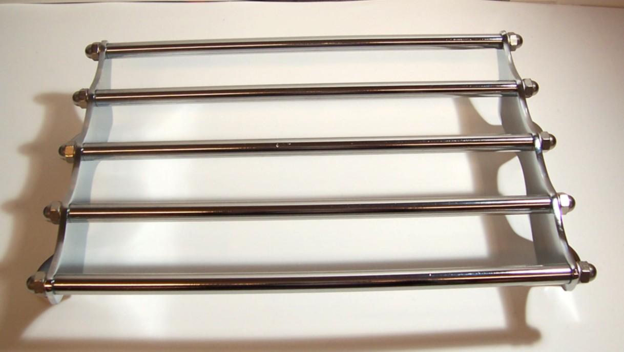

« Reply #6 on: December 15, 2017, 09:14:58 PM »
Hey Bill!
I'm interested in your design.  Have been looking at fabbing my own, but there are not a lot of places to attach things on this bike; the Legacy valk was easier with the fender strut bolted onto each side. Not sure what to bolt to, unless just making vertical risers coming off the fender.
Don't have any close-ups of just the rack, and it's cold outside...  But you get the gist.  I bought (2) Hondaline racks, split 'em lingth wise, fabbed some rectangular and round insets, welded the pieces together, and then welded on another set of ears for the Legacy Valk backrest.
Temporarily, have been looking on ebay a bit for the smallish version that bolts to the Backrest.  While plenty of the "dimpled" Yamaha mounts ae out there, none of the flat mounts that you used.  Do you know if the dimpled could be used if it was simple flatened?  Or maybe just cut off the ears with the dimples and weld on new tabs?

Posts: 16834
« Reply #8 on: December 16, 2017, 04:53:55 AM »
Yeah! That's an awesome and usable rear fender rack, rather than the curved "beauty" rack that
most of us put on our 1500s (if we can find one)...
I want to make a rear fender rack for my 1800, it will replace my passenger seat and grab rails,
and attach to the bike where the grab rails go. It will end up incorporating this old-style Harley rack (or
be based on it):
Also: the Utopia guy sent me the part of a Utopia backrest mount that the backrest bolts onto,
that will be part of my new rack, too... so the 1800 will be solo, with a Russell seat a Utopia
backrest and a nice flat usable fender rack.
I'm jealous of you guys who can fabricate and weld, because I'll have to take my
ideas to a local fabricator and hope he can realize what I am imagining...

« Reply #9 on: December 16, 2017, 07:29:07 AM »
That rack was fun - I can carry (2) cases of beer, no sweat - but it takes 8 bungies... Grin
You'd be surprised what you can do with hand tools, a vice, and good Dremel with a bunch of different tools - cutoff, grinding, carbide, sanding, etc (give the battery powered one to a neighbor kid), a 4" cutoff hand grinder, and a Harbor Freight table top bench sander. My workshop is a 10 x 20 Toughshed...
Most of the time for projects is in design and fab - hours, sometimes days; or longer.  Welding is the least amount of time - usually minutes.  I did eventually get a MIG welder a couple years ago, but unless you use it daily, your skills do not improve.  Unless it is something really simple, I generally just tack stuff into place, and then take it to 1 of a couple good welders I know for welding quality I trust.
That said, every time I weld my grinding skillset improves nicely... Wink

Here is an "exploded" view of the rack (with the grab rails removed).
You can see in the image that the sissy bar has its own mounting tabs - stack it, or not.
And, as I described above, the grab rails are welded to the outside tube of the rack.  So, to add the grab rails, notch the front ends of the rack, notch the rear ends of the grab rails (so they lie flat on the outside tube of the rack), and weld.  Presto! Canted grab rails.
So, the rack can be used with or without a rear seat and sissy bar.
As far as the center insert goes (the insert rack that fills the void when the seat is removed), it can easily "stack" and bolt to the four mounting bolts that hold the rack (like the sissy bar does).
Any suggestions for the "look" of the center insert?
Bill
EDIT:  as I think about this I wonder if the grab rails could be made to bolt to the rack, rather than welding them in place....  BH

Didn't take a nap after all.  Here's a rack with an insert, ready to go (I think).  I am concerned about the front edge of the insert hitting the rear of the rider's seat.  Need to do some careful measuring to get it just right.
Top view:
Ortho view:
Cheers!
Bill
EDIT:  The insert has its own mounting tabs so it can be removed and the rack can be left on the bike (with rear seat installed, etc.).

I finished mocking up the rack this morning.  I did just the rack - no sissy bar or grab rails.  Here are some photos - first without the "flip" at the back of the rack:
Top view:
Side view:
Now with the "flip" added to the back of the rack.  First, perspective from front:
Perspective from rear:
Side view of "flip":
Having done this much I can tell the front ends of the rack just have to be curved down.  Without those curves (and without the "flip") this is just too plain to put on a Valkyrie.
I'm still not sure about the space between the rails of the rack and the edge of the seat.  Things are really exaggerated in the photos because of the height of Judy's pillion (it is, er, "padded").  But, the sissy bar will mount in the space between the seat and the rack side rails so, maybe, it will be okay.
The width of the rear fender on this scooter is pretty big - I widened the width of the rack (compared to the Star rack that I am currently using) to "fit" the width a bit better.
I'll mock up the grab rails next to see how that affects the overall look of things.
Other thoughts?
