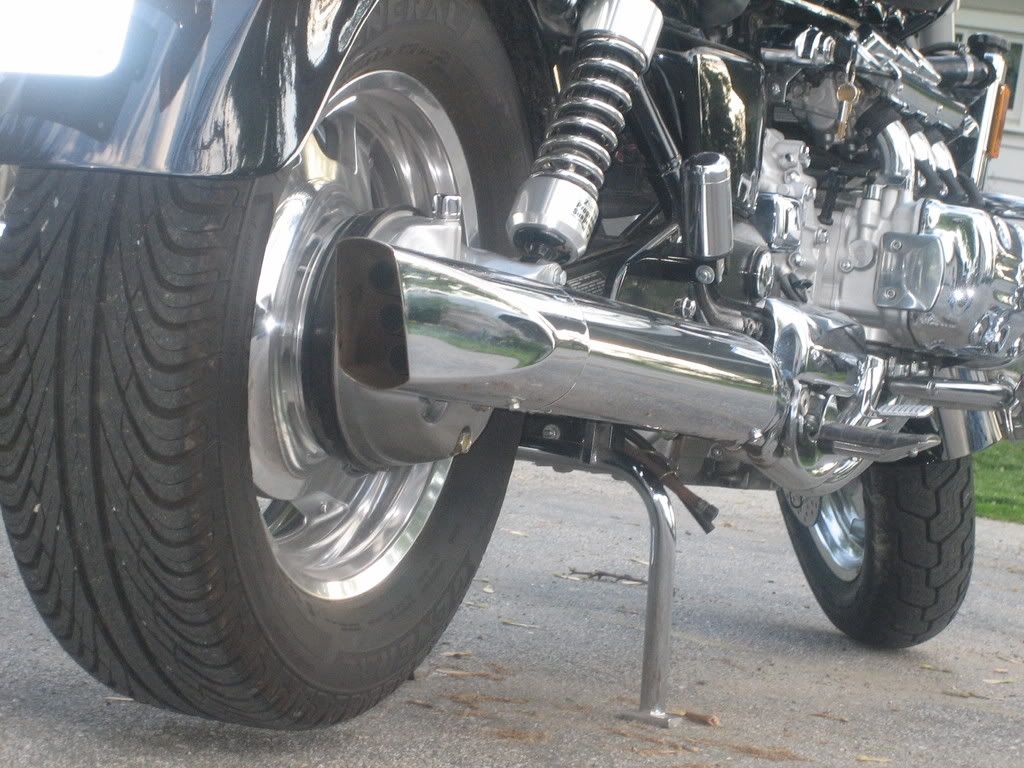

Do you have a picture with this set-up Jim ?

Current setup Mich Hydroedge 205/65/16 and K491 EliteII front
Original @ 30k
current front

I have the same tire as Fla. Jim.  The size is MT90HB17.  I believe this is the same as 130/90-17.  It is a bias ply tire.  It is a rear tire that both Fla. Jim and I have mounted backwards (reverse rotation).
When I installed this tire, I had (and still have) a 205/60HR-16 General Altimax HP on the rear (I was removing the OEM Dunlop from the front).  The first thing I noticed was that the counter-steer I had since installing the rear tire was eliminated.
BUT, the other side effect was that I have lost stability at speeds over 85 MPH.  I now have about 7,000 miles on the rear tire and 5,700 miles on the front tire, so I expect that any break in or wear in period is over.  This really does not bother me as I do not ride at speeds over 85 MPH.  (I believe Fla. Jim experienced the same effect.)
As far as performance, the tire is touted as a high-mileage touring tire, so I would expect that this is not a soft or sticky tire.  I have no problems in the rain or curves, but I hardly ever have my pegs tough the pavement.
The tires were only about 1000-2000 miles "old" in the photo.
Due to the high speed stability problems, I do NOT recommend this tire combination.

Nice write-up....Thanks  cooldude
