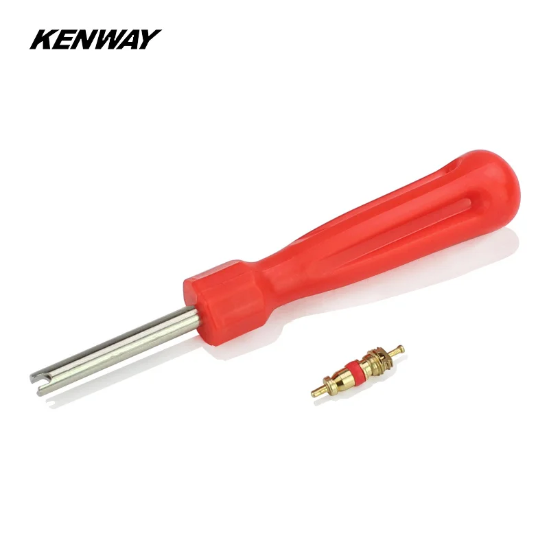

Schrader valve.  (needle in the valve stem)
Schrader wrench.
Though some valve caps have a built in wrench.
It is pretty rare to have a Schrader valve back out, but it happens.  Anyone with a mystery leak that cannot be found should check those valves (and the rim/bead contact).  The old warm soapy water on a brush test will show bubbles at the valve stem.
Schrader wrench.
My aftermarket metal valve stems have high quality aluminum caps with Orings in them.  They should capture the air from a loose Schrader valve. (unlike the cheezy rubber caps)
I know nothing about these TPMS gizmos, but I'm betting the Schrader got loose on their installation.

The Wing only has 4500 miles, so the schrader valve was not tighten at the factory. The thing is in that 4500 miles the back tire held pressure the whole time. I never had a problem with it before that Saturday. I also replace the plastic tire caps with metal ones months ago and it still leak air. I guess I'm going to have to buy one of those tools to carry on the bike.
