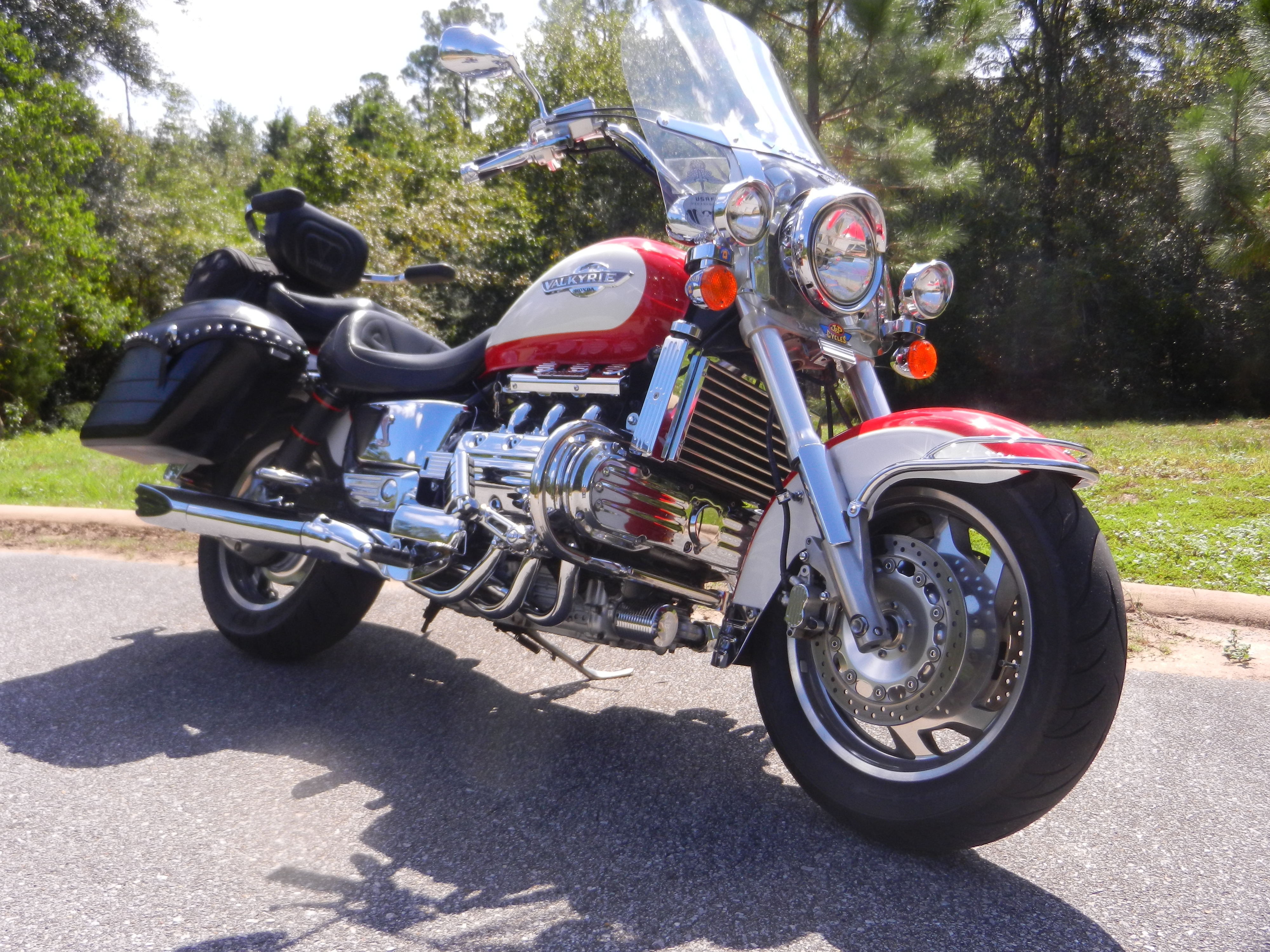

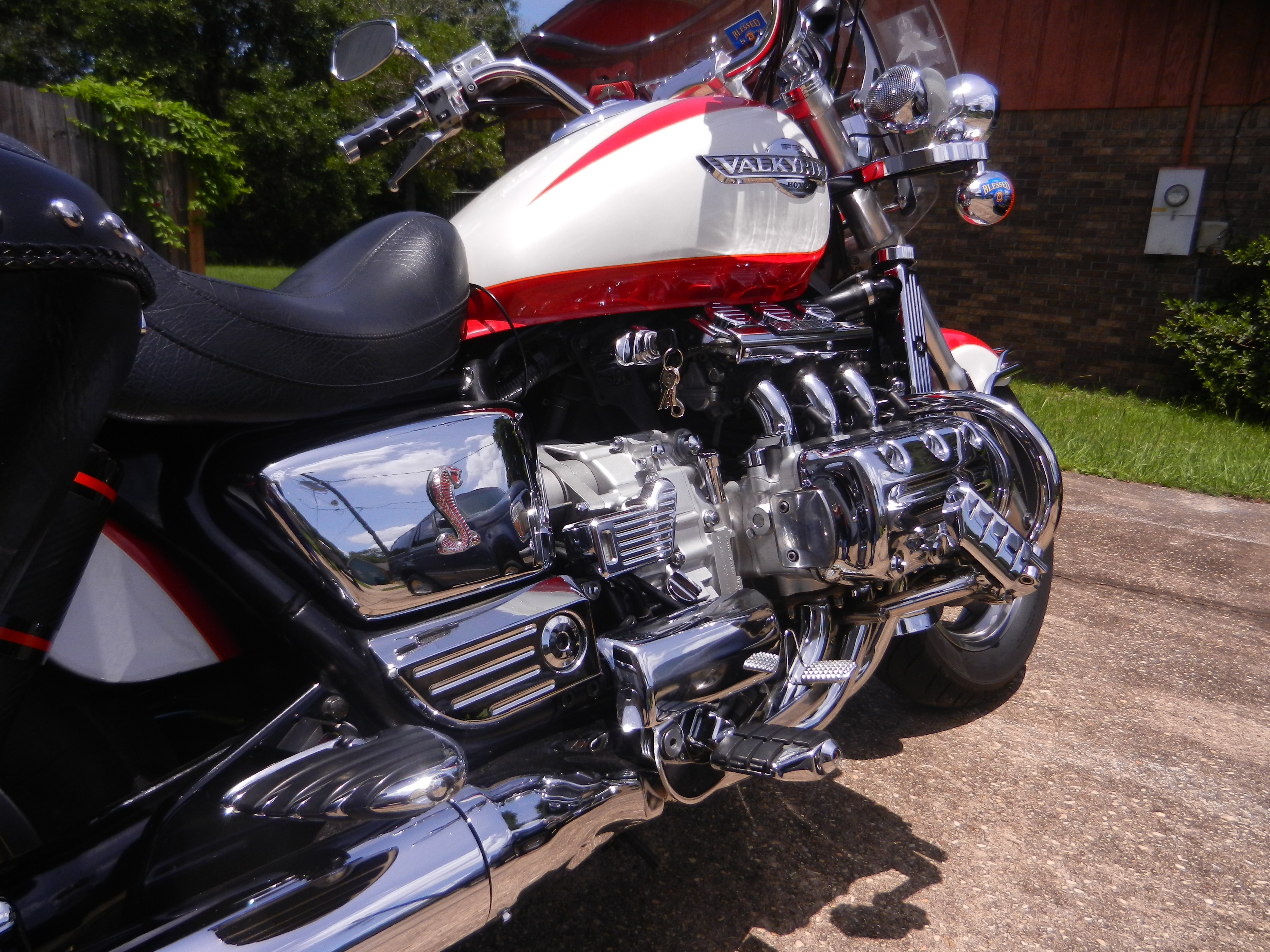

« Reply #6 on: December 24, 2017, 06:02:51 PM »
Jeff, can you point out with a pic everything Cobra, seeing you have the Cobra cover gurl?  I finally got the light bar.

« Reply #7 on: December 24, 2017, 06:28:13 PM »
In the pic shown i see the radiator sides, light bar , rear brakereservoir cover and the tops on the carbs
I dont see the cobra gap fillers on that bike .....
Or the cobra things behind the bags ......
In addition to those things mentioned, it has the oil filter cover, neck cover, final drive bolt cover, clutch and brake m/c covers upgraded Cobra spots, tripple tree top three bolt cover set, radiator cap, oil filler cap, dip stick and front caliper cover.  It also has Cobra swing arm covers
