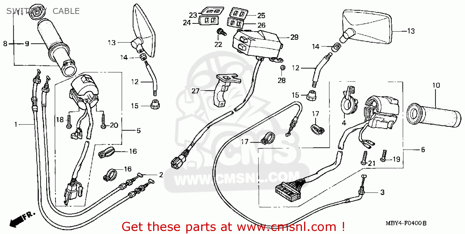

Sometimes finding the right schematic on OE parts is tricky.  It's not under handlebars, it's under switch and cable.  I think you need a #8.
https://shop.procaliber.com/oempartfinder.htm?aribrand=HOM&arian=MOTORCYCLE#/Honda/GL1500CFA_(99)_VALKYRIE_INTERSTATE,_USA,_VIN%23_1HFSC410-XA000001/SWITCH_+_CABLE/GL1500CF-99-A/14MBYXE1AMBY4F0400BC

Grip sleeve and switch assembly is what you will have to order if you order new OEM
