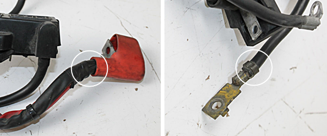

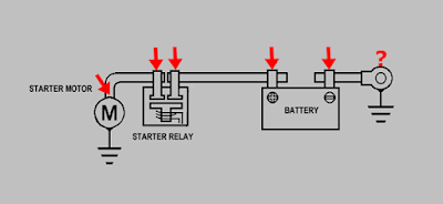

It sounds like a loose connection in the heavy gauge wire circuit especially with that "all the power went off". Usually either the battery bolts aren't tight enough or the nuts on the starter relay, on those two copper posts, aren't tight enough. The battery wires might be frayed at the crimp from all that bending throughout the years, something like the second pic. They're hidden under the sheathing, and happened to me.
