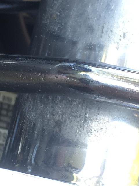

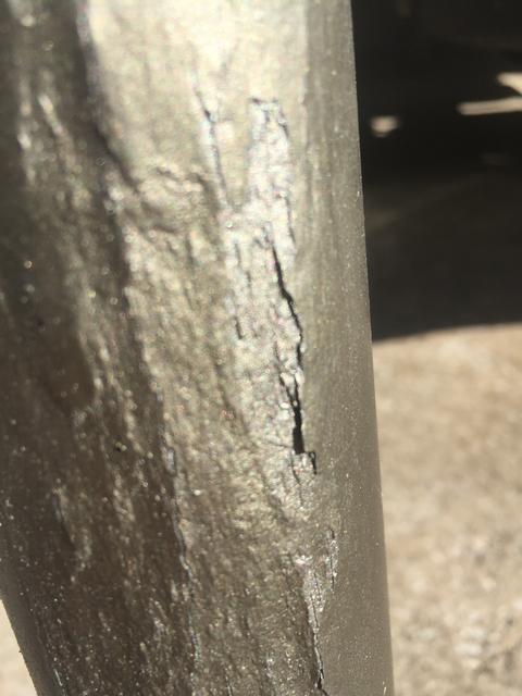

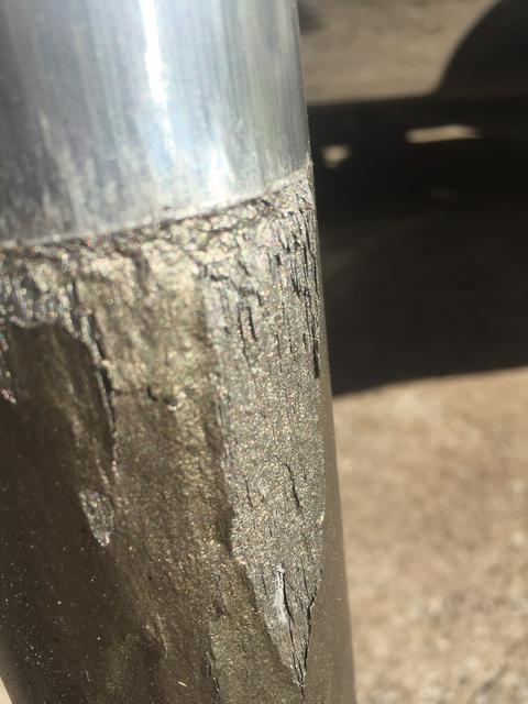

« Reply #21 on: September 21, 2018, 04:29:38 AM »
]Sorry guys. Not very tech savvy. Had my kid help with Facebook photos and didn’t work as planned.
Singed up and trying another.  The two pictures with paint, original forks. Kept getting worse no matter what I tried. The other two are my new ones. They were polished and kept clean with white diamond.
Hopefully you can see them this time. A32E8FAC-EBAB-4E6E-A4BE-54E188BECA74[/img]

« Reply #22 on: September 21, 2018, 04:58:39 AM »
 Shocked I've never seen anything like that.

« Reply #23 on: September 21, 2018, 05:07:28 AM »
+1.   yeah it's like do you live on mars or something?
-Tom
« Reply #24 on: September 21, 2018, 05:43:07 AM »
That looks like someone has sprayed a corrosive on to the forks.
Damn that's weird.
Savago
Posts: 1994
Brentwood - CA
« Reply #25 on: September 21, 2018, 12:00:11 PM »
Really weird, it is like the aluminum is flaking.

« Reply #33 on: September 23, 2018, 12:06:28 AM »
Hi Jims99!
The aluminum 'flaking' is called Intergranular Corrosion.
I have seen it on some equipment my agency used to make, I have seen it on old, abandoned airplanes..... and I saw it on the forks of my '97 Valkyrie when I first bought it.
This happens when certain aluminum alloys are unprotected in a corrosive environment.
Some alloys corrode much more easily than others.
For instance, alloy 2024 (a common aircraft alloy) uses copper mixed in (alloyed) with the aluminum to make it stronger. But....the copper atoms form a 'galvanic cell' with the aluminum, and all it needs is some water.... dew and a little dust to give it some electrical conductivity works just fine..... and the corrosion is 'off and running'. Pure aluminum is pretty corrosion resistant.... on airplanes the 2024 'skin' is 'alclad'.... coated both sides with a few thou of pure aluminum  to reduce corrosion.... which is fine out west in a dry climate.
In a more humid environment, it's either paint, or it's Corrosion City.
By the way, this corrosion became a problem in some states out west when they switched from regular granular 'calcium chloride' road salt to a sprayed liquid 'magnesium chloride'.... which was SOLD to them as being 'non-corrosive'......NOT!  They had aluminum semi-truck trailers failing due to corrosion!
link: https://www.peterschemical.com/magnesium-chloride-as-a-road-deicer-a-critical-review/
The outfit I worked for (USGS) had some aluminum cablecars that the guys would ride out over streams to collect water samples. We had a car that happened to be stored right next to an interstate  highway in Colorado.... the car was fine for decades until the state started using magnesium chloride de-icer on the highway.... spray mist got over on the cablecar with each snowstorm, and some of the parts, those  which were made of 2024-T4, just corroded like mad. The rest of the car was made of 6061-T6 and 3003, and did not corrode. I changed the alloy on the problem parts to 6061-T6 and the problem went away.
I looked up Ormond beach and I see it is on the Atlantic coast of Florida, somewhat north of Cape Canaveral.
My guess is that salt is getting onto your forks, and along with high humidity, is corroding the heck out of them.
Are you close to the water?
Are you having different weather?
Are you getting salt spray... maybe riding along the beach?
Are you getting more of a wind from the east...I am thinking salt-water droplets evaporating and microscopic salt flecks carried to wherever your bike is.
Did your Valk do OK for years, then suddenly start to corrode, or did you have different bikes?
The only thing I know to do is to clean the forks down to shiny metal, then COAT them to protect them.
I live on the Gulf Coast in Mississippi, about 200 yards from the water, and things corrode like MAD here!
My '97 Valk had been sitting on a guy's front porch for about 5 years, maybe a mile inland from the beach. There were areas of SEVERE intergranular corrosion on the forks..... almost as bad as your photos!
I removed the forks, then used a coarse 'bastard cut' file to remove the corrosion-- it was pretty deep!. Next was a 'smooth cut' file to remove the 'bastard cut' file marks, then 100-grit sandpaper to remove the 'smooth cut' file marks, then 220 grit to remove the 100-grit marks.
I stopped at 220 grit, but one can go as fine as one likes, followed by polishing to whatever finish one wants.
To coat the forks and keep the corrosion from forming on the new shiny bare aluminum..... PAINT 'em!
I used RustOleum Clear aerosol paint, and it looks OK a year later, but I keep the bike in a shed. (It's still humid as heck, but no direct salt breeze.)
I have several bikes, and the Valk is the only one that the forks are corroding like this. My Buells, my old Suzuki dirt bikes, and the old Norton forks that got dunked in salt water in Katrina, the aluminum forks are just fine.
My guess is that the Valk forks are made of an alloy with much less resistance to corrosion  than the other bikes.
I hope this helps!

Now my brain hurts but thanks for that reply.
Jims99
Posts: 825
Ormond Beach Fl.
« Reply #35 on: September 23, 2018, 05:10:08 AM »
Thanks Jimbob.
That does help. I do ride down A1A once in a while, but this has only done it on this bike. I’m going to go through and check all grounds and repolish and try clear coat. If it doesn’t help, may try switching to vtx forks. It just baffles me, after riding different bikes for 42 years (90% in Florida) I have never had this before. Always lived within 4-5 miles from the ocean and no ones bike I know has ever done this.
Just chalk it up as a learning experience. And will definitely post if I find something odd with bike.

JimBob beat me to it. Intergranular corrosion with exfoliation ("leaves" flaking off). I haven't seen that since the helicopters I worked in Hawaii. Trouble is, it's insidious. Once you see it, it's already deeply attacked the grain structure. You can abate it, but not cure it. Plus the oxidized material holds moisture that much more, too, exacerbating the problem.
Any chance you travel on a dirt road? Calcium chloride is also used for dust abatement, and to help keep the dirt from washing away.
I have to be diligent about washing and waxing my bikes, living only a few miles from the Cape. Between the salt air and winter roads, MA is tough on vehicles. I don't even ride my bike to work any more because the parking lot is about 40 feet from the water.
It's fortunate (and sad at the same time) that parts are getting pretty inexpensive on eBay.
