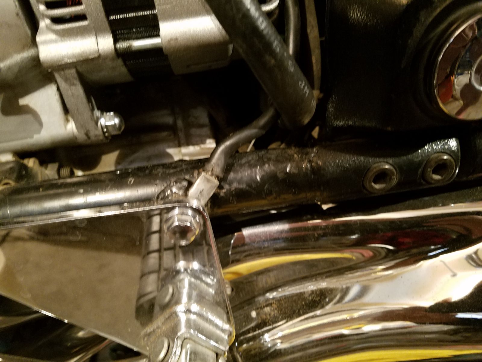

« Reply #53 on: January 24, 2019, 10:51:01 AM »
I think I'm onto something.
Finally built up the enthusiasm to dig back into the valk. It's been difficult recently with the way things have been going.
It fires right up, idles, and then dies in the driveway. That's not new, but I noticed something more significant - there's a loud, random ticking sound immediately after it dies, no rhythm to it, very sporadic. It's coming from the starter/ignition area. What in the hell could tick like this, the ignition itself? Or possibly a bad ground? I've never even heard of anything like this before so I'm unsure of where to go from here. I'll scour the Clymer manual in the meantime.
Cheers, gang.

Posts: 30837
« Reply #54 on: January 24, 2019, 11:12:11 AM »
Might this just be the exhaust heating up?  I know they all tick from heat at shutdown.
The way you describe it, it seems like heat may be the (or an important) issue.  Starts, runs, shuts off.... heat?

« Reply #56 on: January 24, 2019, 11:51:00 AM »
That's what I'm thinking. This ticking has to be the important issue. It's a very localized sound near the starter or ignition, highly doubt it'd be the exhaust based on the sound.
