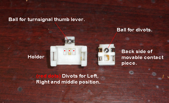

« Reply #21 on: February 16, 2019, 02:30:33 AM »
I think probably the most important part to clean is down inside the little white plastic box. You can do that by moving the switch to one side, cleaning with a Q-tip and doing the same with the other side. I went back and forth a few times with some degreaser on the q-tip.
You can deep clean the contacts by removing the thumb lever. All it takes is removing 2 internal screws.
With the thumb lever out of the way, you can remove the holder (B). The holder is just friction fitted in a recess and simple to pluck out. This allows you to separate the stationary contact from the movable contact.
This way it's easy to clean the copper contacts and the coil spring under the contacts, and any encrustation on the legs of the contacts. The legs slip up and down in the side slots.
The stationary contact has a ledge that overhangs the movable contact (left pic). This makes it hard to work contact cleaner into the crevice even with a thin straw without separating the contacts. Grundge  tends to collect or gets trapped on the turnsignal contact which sits on the top row. Not as much on the running light contact on the bottom row.
Also, the movable contact has a spring loaded ball that slips in and and out of divots. Crud can build up in the divots.

Excellent instructions, RonW cooldude
