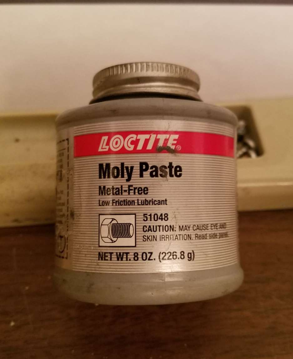

« Reply #13 on: March 02, 2019, 08:34:33 AM »
Loctite for me.

« Reply #14 on: March 02, 2019, 11:36:53 AM »
This is what I bought. I am using it for the first time now, so I can't comment on it's longevity or anything. https://smile.amazon.com/gp/product/B001HWBSJW/ref=ppx_yo_dt_b_asin_title_o08_s01?ie=UTF8&psc=1
This stuff is for bolt threads that you don't want to rust. It's not for wheel splines or drive shaft splines.
Per my conversation with a lubrication engineer from Amsoil (not the company that owns Loctite or Permatex), it is ideal for the job. Adequate amount of Molybdenum with a suitable carrier. Though the containers look similar, this is not Loctite Nickel Anti Seize. The Moly Paste can be used on fastener threads, but it is not limited to that.
