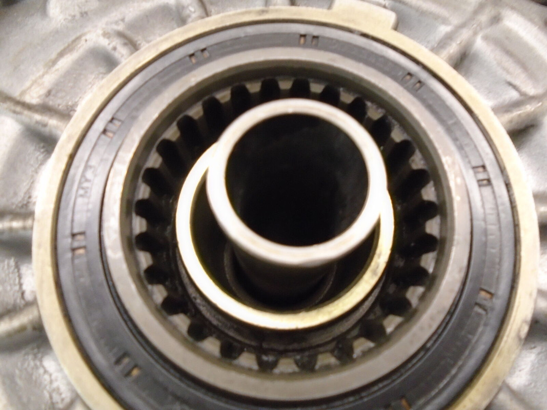

Hi folks,
I'm about to pull the trigger on a Valk diff and would like opinion on the state of the splines.
I would rate these as good to very good (but obviously not perfect). Can anyone see any reason why not.
Also, I believe that all Valk F6C years have the same pumpkin, if someone could confirm this it would be much appreciated.

From what I can see in the pictures I would say very good.

I wouldn’t hesitate as long as the mated flange comes with cooldude
« Reply #3 on: October 23, 2019, 03:09:14 PM »
+1
As to the pumpkins. The only difference I know of is the 01-03’s had polished and clear coated ones.

Thanks Gents.
I just bought it. Unfortunately not including the hub/flange. Fortunately I have an almost brand new one of those on the shelf.

Just make sure you use good grease and the proper sequence putting it back together. Mismatched flange is not ideal but those teeth look good enough to afford any initial wear to become a matched set

I think they look good.
This one is going on my spares shelf. I couldn't pass up the deal and these things are getting hard to find.
I've already replaced my diff once as a result of a repair shop changing a tire 3000 miles from home and putting totally the wrong grease on. When I got it home the whole thing was practically dry and well worn. Probably didn't even reassemble it properly. I learned my lesson that day...never trust anyone else with my 'bike!.
Thanks again to all who chipped in with opinions.

You do know that you can use the splines out of a 1500 Goldwing pumpkin in the 1500 Valks.
You just have to take apart the pumpkin on the wing, take out the final gear and press out the center where the spline are.  The spline cup can be separated.  Press the center out of you final gear and press in the wings.  It is a heck of a lot cheaper than buying a Valkyrie pumpkin.  1500 wing pumpkins go for cheap.
I did this a number of years ago.
A brand new final gear is only $250 usd from Babbits.

Yup, thanks bscrive, I am well aware of that. In fact I was planning on doing it but getting one in Canada was WAY too expensive and getting one shipped from the US was just the same after I include shipping. Plus, I don't have easy access to a press or anyone that has one around here.
And if you change the ring gear, you are now messing around with shims.
I wasn't looking for this one, i just came across a local ad and believe me, the price I got it for was really a deal, so it'll be my good spare.
I might actually have a go at the spline swap at some point if I come across a 1500 drive really cheap (I have a really well worn final drive as well).
