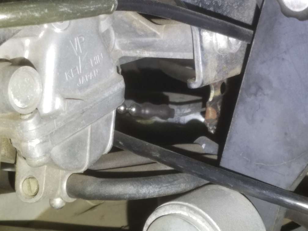

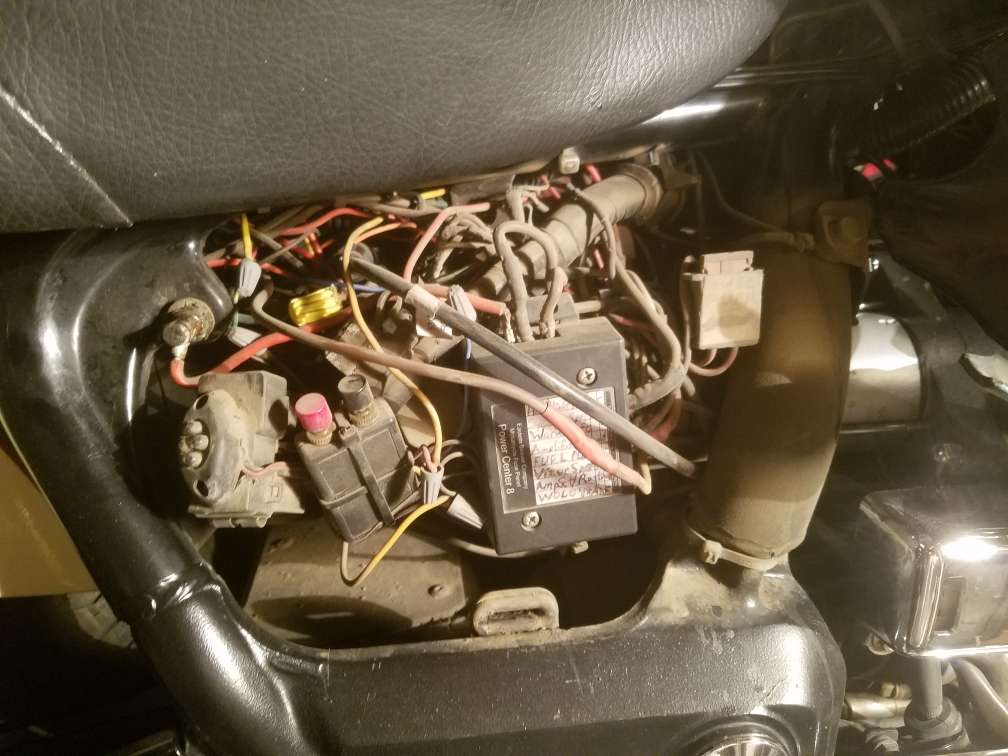

I guess it was the Rostra 250.  Put the servo/control box behind the battery which I moved fully forward and shimmed it there with a small block of wood at the bottom of the battery box.  I cut out the dividers in the box so I could move things where I needed them.  Rerouted the heavy electrical cables at the starter so I could move the battery more forward.  The throttle pull cable goes out the right side and curves forward inside the plastic cover.  In this pic, it's routed outward past the PC-8 fuse panel.
It goes past the starter and makes a big 270° loop to connect to the throttle linkage between #4 & #6 runners.  I made a bracket to hold the end of the cable housing in the right place.  The bead chain and the bracket I made:
