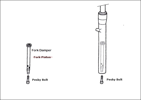

Typically a manual states to put everything back in the fork (springs, collar etc) and screw on the cap, than compress the fork upside down. The pressure against damper supposedly keeps the socket bolt from spinning. The damper is what the socket bolt screws into. Put a cardboard, cloth, etc. on the floor so the fork cap don't get scratched up.
I've been using an impact screwgun to install the *pesky bolt.* The torque value is an educated guess though.
The fork damper is the same thing as the fork piston on other bikes which uses a socket bolt on the bottom of the fork (pic below). In the right pic, since you're physically unable to grab the fork piston while screwing on the socket bolt, it's like trying to screw a cap on a jar without holding the jar stationary. Some fork pistons have a recess which a special tool fits into (bottom pic). The tool holds the fork piston from spinning when screwing on the socket bolt. The Valk forks don't have anything like that.

The aluminum part with the threads is spinning inside the steel tube. Is that normal? Seems like it should be locked so it dose not spin inside the tube.
[edit] Try feel if the damper rod spins freely in the thicker part of the damper. Try again with the damper rod fully extended ......
If by the slimmest of chance it does not .....
..... screw the fork cap on the threaded end of the damper and try use it to keep the damper from spinning. Don't use the spring collar and the fork spring (inset graphic). You might use locknut 19 to keep fork cap from bottoming out.
