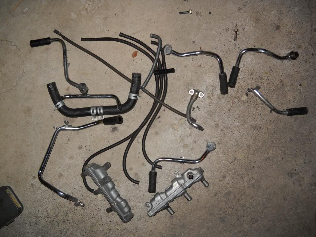

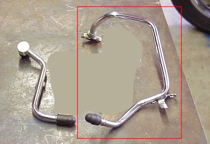

here is my top desmog plugs. Used shortened 9/16" bolts. Filled the holes with quicksteel. Then some hi-temp silicone and installed the bolts.
did this to the original heads. zero problems even after 50k miles.
bottom aluminum desmog plate. just fill the hole and plate surface with hi-temp silicone.
http://www.valkyrieforum.com/bbs/index.php/topic,105991.0.html

« Reply #37 on: January 27, 2021, 04:02:09 PM »
I desmoged my bike about 3 months ago, a 1999 Tourer, desmoged and installed the Heat Sheild.  Heat sheild was a bit harder, but not to bad.
Posts: 15202
« Reply #38 on: January 27, 2021, 06:53:10 PM »
I did it with the Schmidt kit. It involves a set of JB Kwik, my air driven hack saw, and a bit of patience.  After removing the tank and airbox I unbolt the central mess and toss it, along with all the associated tubing. Then fire up the compressor to use my hack saw to cut the pretty metal tubing that goes around the end and under the cylinder heads. Where they connect to the plug on top of the heads, I cut it off flush. Where it curves around under the heads to that little "thingy" underneath, I cut it off near the bottom of the tube where it starts the curve under. I don't bother to remove the thing under the head, not  needed. All the metal tubing I cut I merely fill with the JB Kwik, usually a couple layers, cap off the unused vacuum ports, and by the time you get the airbox and tank back on the JB Kwik has set and you're ready to ride. My cost is whatever the going price is for some JB Kwik. I use short pieces of the cut off rubber tubing to fill with some gasket sealer before running a small screw or bolt in, then slip it on the vacuum ports just uncovered. Pick a rainy day and give yourself a couple hours.
If you don't want to pull the tank/airbox...don't. Merely use some long needle nose pliers to remove the tubing connections. This will inactivate it, then cut & fill the metal tubes as described, cap the vacuum ports and you're done. Then, next time you have reason to have the tank/airbox off, unbolt the central unit and toss it.
