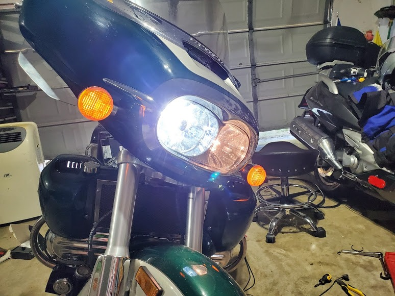

As I was swapping out the Halogen bulbs for LED in my new to me Interstate I took a pic with one LED one Halogen. The pic doesn't do it justice, in person the LED is even MORE!
...and I have no connection or profit from this, but these are the bulbs I used. You just have to clip off the bottom 2 clips from the base, and they drop straight in..... GREAT upgrade for an Interstate!!!
https://www.amazon.com/gp/product/B07BTW6RCG/ref=ppx_yo_dt_b_asin_title_o01_s00?ie=UTF8&psc=1
You're talking the same two tabs you cut off any standard auto parts H4 55/60 bulb, right?
(A lot of the other LEDs guys have used required more mod to the hole or retaining ring to fit a bulb fan.)

« Reply #2 on: August 25, 2020, 05:12:37 AM »
I used superbright led bulbs, sounds like the same ones had to clip off the two nuns but love them so far.
I also did trunk lights main 7443-R27-T-CK-2pk  and smaller lights were 74-RHP3

« Reply #3 on: August 25, 2020, 05:40:13 AM »
I also installed these bulbs a week ago, bent the two lower tabs back towards the 3 pin socket,  they dropped right in just like any other H4 Auto bulb. I haven't ridden at night but during the day I could see the lights reflecting off of road signs, pretty bright, I could also hear the small fans running when i stopped the bike and killed the engine, it was in the mid 90's.

« Reply #4 on: August 25, 2020, 05:43:51 AM »
Correct, clipping off those two tabs was all I had to do, other than that they went into the sockets normally (Well, normally as that ever goes, especially when you've got giant plumber's hands like I do) and the existing wire harness plugs right on, nothing more to it.
I've been running these same bulbs on m other Interstate for around a year now, and no problems to report, very glad I made the change (Although I'm sure some drivers in front of me probably aren't, I try to aim the lows a little lower than normal for that reason, but just a hair.)

« Reply #5 on: August 25, 2020, 06:57:41 AM »
How's the hi/lo-beam pattern compare with that of the stock halogens?

« Reply #8 on: August 26, 2020, 05:54:56 PM »
How is night time focus? I did pathfinders on 1500 wing and left side low beam has a hi spot.  Haven't messed with it. Had planned doing IS as well.
