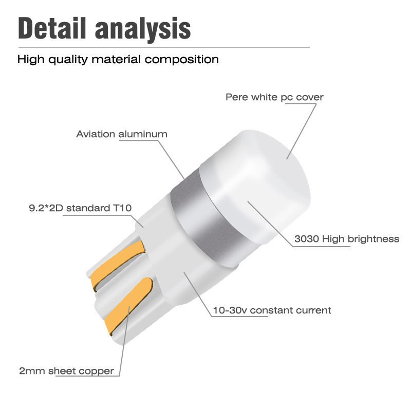

Posts: 220
Germany
« Reply #4 on: September 25, 2020, 07:01:30 AM »
Superbright is quite praised here for some reasons. No mistake to order there.
Nevertheless, for you cheap guys out there - these LEDs do remarkably well and have not the flaws of simple LEDs with just resistors for a voltage divider. (read: no thermal problems esp. for higher outputs and/or when placed in isolated rubber fittings, no polarity issues and better contact surfaces):
NOT dimmable, though.
You may order in different colors for fun or test purposes, too. Just add a line after purchase.
1.99 USD a pair.
They do work for more than a year now w/o issues, where others miserably have failed after a few weeks...

But with the turn signal indicator things got interesting. Seems that with indicator light the polarity changes when you switch from right turn to left turn, so the led will work only on one side, depending which way the led was positioned.
I think there could be enough space in that rubber sleeve to fix 2 T5 leds side by side. I was thinking that if I could solder one bulb mount to 2 led's so that both have opposite polarities it should work.
It should work, right?
Just use a LED bulb that is equipped with a constant current driver - these LEDs have a non polarity design.
-mike-
-mike-
Great!
Well, it seems that that kind of led's are bit more difficult to find, so I went with my idea and it works Smiley
