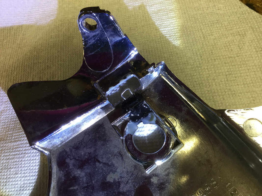

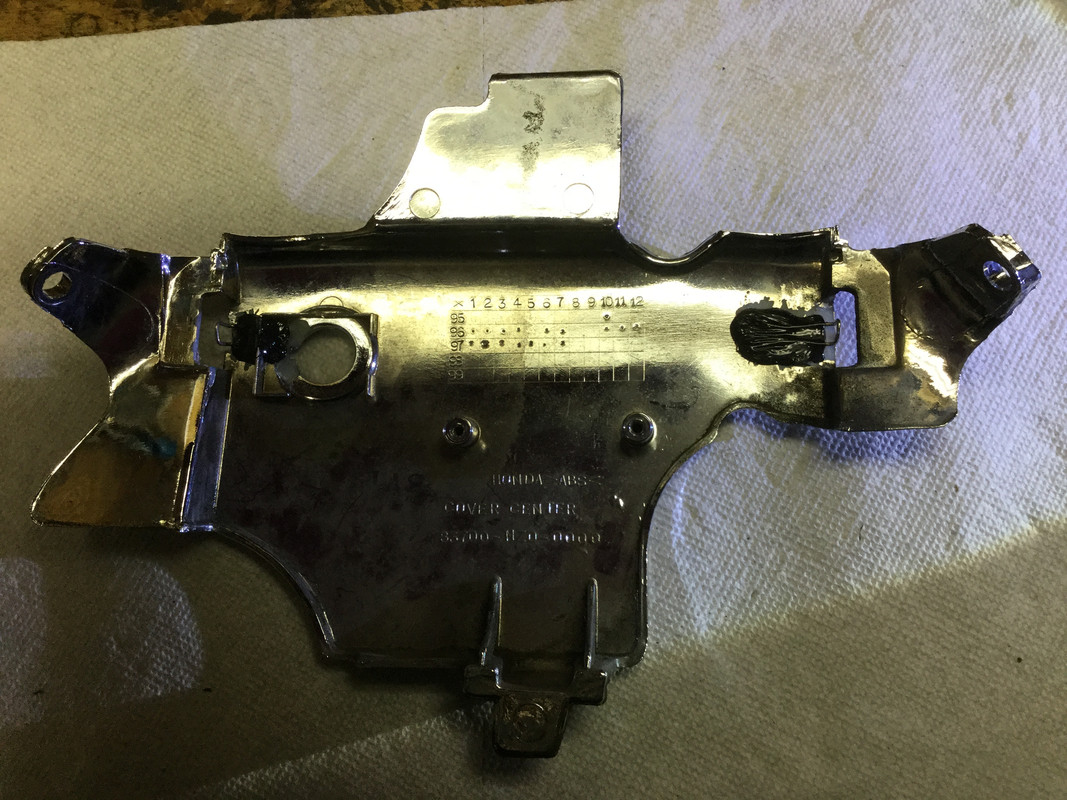

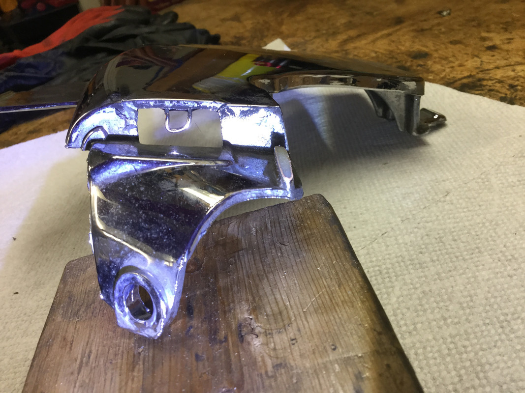

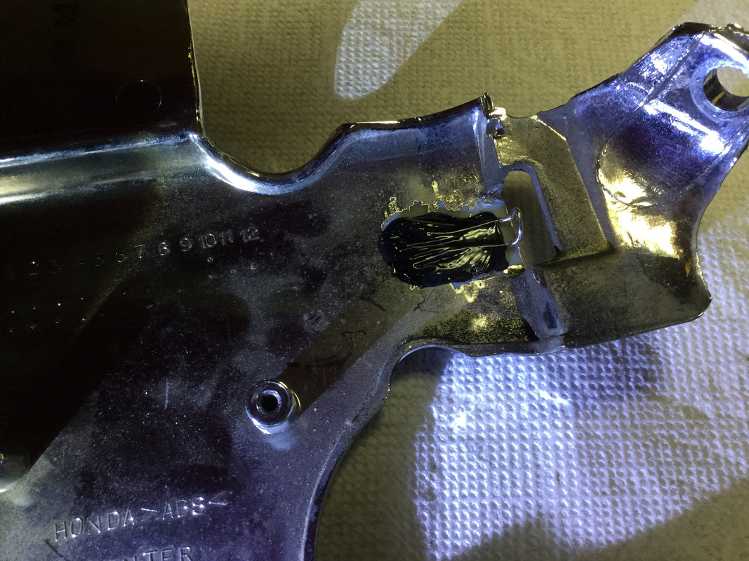

I fixed it this way.  I am not saying it is the best way to fix it but it is working.
I had one side cover tab beginning to crack so I took the handle wires from a heavy duty paper clip and bent them to a usable shape and reinforced the tabs with them using black ABS cement.
Then, while on a trip, the center cover tabs cracked and one side panel fell open.  When I got home, I used another paper clip to make a similar repair on the center panel.  The following photos are of the repair on the center panel.
I agree with Avanti about the stud at the rear attachment point for the side covers.  I believe it often puts  just a little too much strain on the tabs.  I know that I gave up on putting new grommets in the covers where they slip over those studs because they would be torn after the first use even when spraying silicone lubricant on them before using.  And the first time installing the side cover with new grommets would require a scary amount of pressure.
