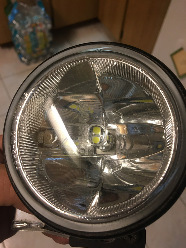

Posts: 15347
« Reply #13 on: March 18, 2021, 04:24:14 PM »
John, if you are going to replace the halogen lights in the pod lights with LED bulbs look for projector bulbs they have a lens in front to enhance the light they emit.
I also removed the diffuser cap inside the lamp housing to further the amount of light given out.
The cap is there for halogen style bulbs.
Here is what the lamp looked like before and now.
https://postimg.cc/gallery/HyGVQ5b
I have one of the lamps off now, got the replacement LED's in yesterday. Changing out the bulb is easy but darned if I can figure out how to get at the diffuser cap you mentioned. What's the secret?

« Reply #14 on: March 19, 2021, 01:14:08 PM »

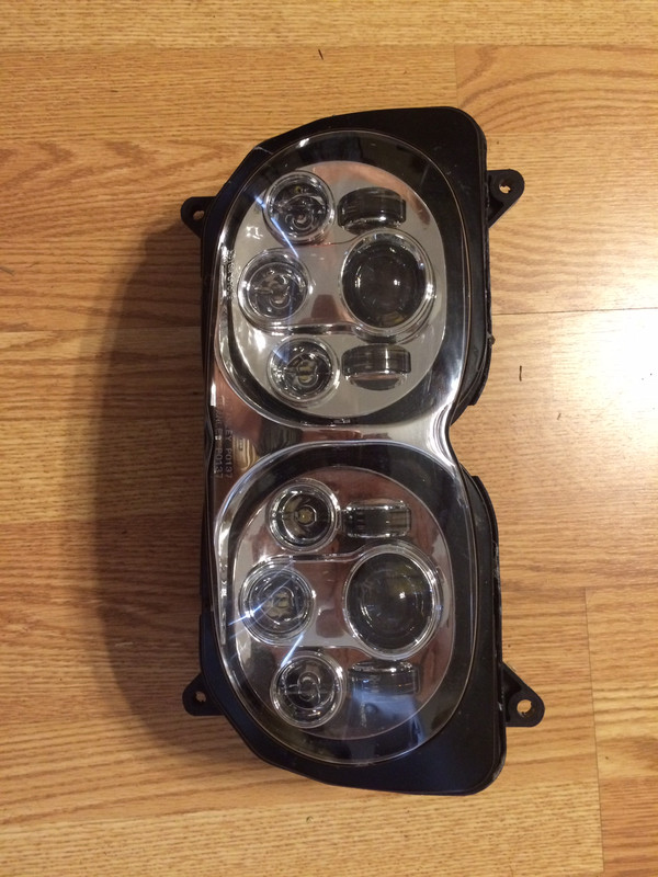

Avanti
Posts: 1409
Stoughton, Wisconsin
« Reply #16 on: March 19, 2021, 06:17:02 PM »
What manufacturer and part number are the headlight seal beams?
Steel cowboy
Posts: 1291
Spring Hill, Fl.
« Reply #17 on: March 22, 2021, 05:52:29 PM »
Harley Davidson Road glide lights, but there are so many manufacturers out on EBay that I can’t remember were I bought them.
2001 black interstate
2003 Jupiter Orange wing

flatsixlover
Posts: 99
Catonsville, MD Patriot Guard Rider VRCC#28566
« Reply #19 on: April 16, 2021, 02:24:42 PM »
Doing the same to my Pods, did you ever learn the secret on how to remove the diffuser cap?
Posts: 15347
« Reply #20 on: April 16, 2021, 02:47:39 PM »
Nope and messed up the reflector in the one I tried to remove so replaced them with some for a '99-2000 Cvic...almost identical. Installed two new halogens and will leave it at that.
