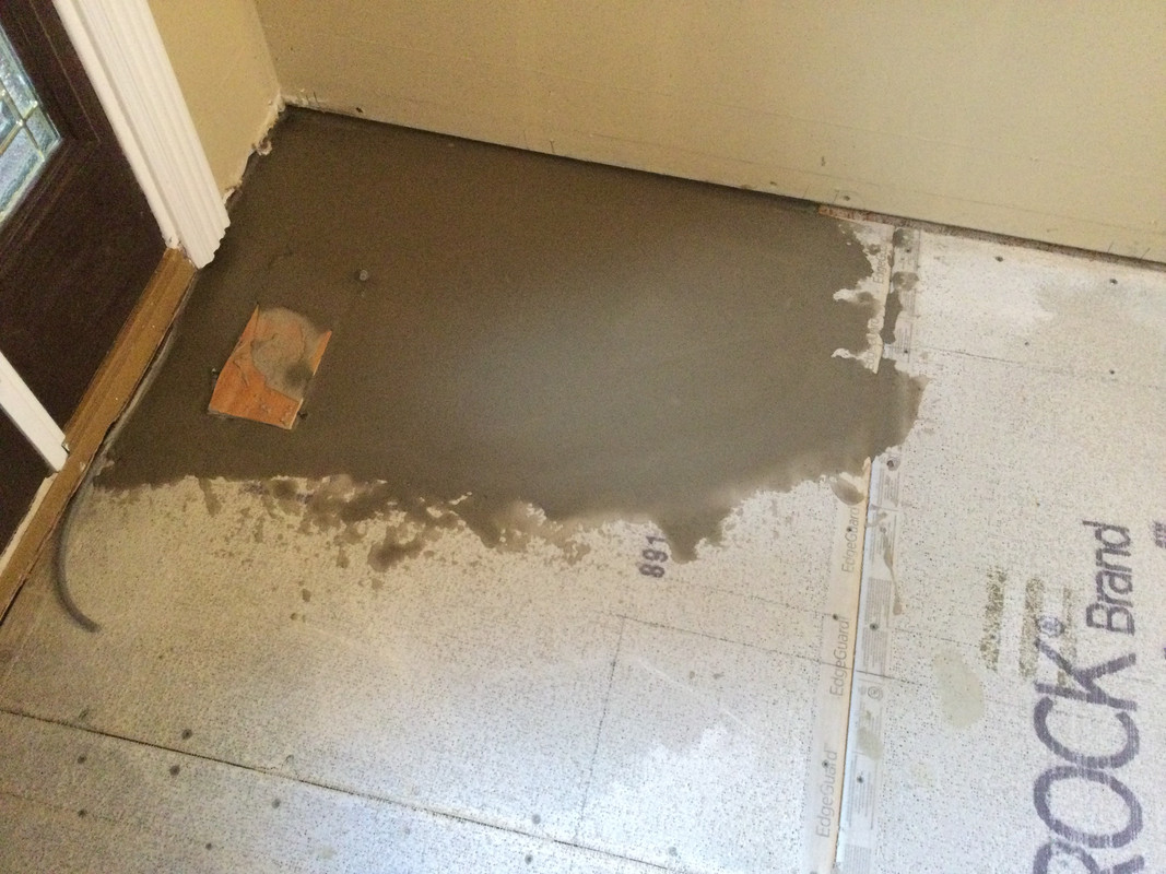

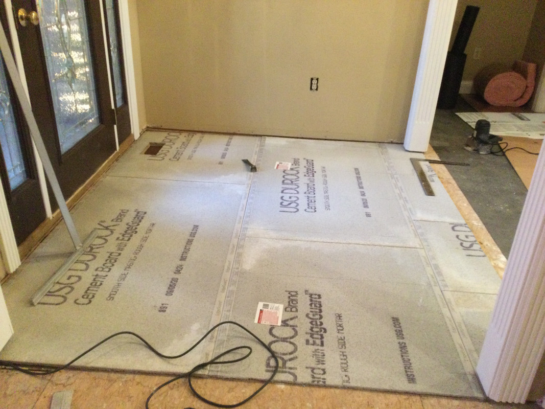

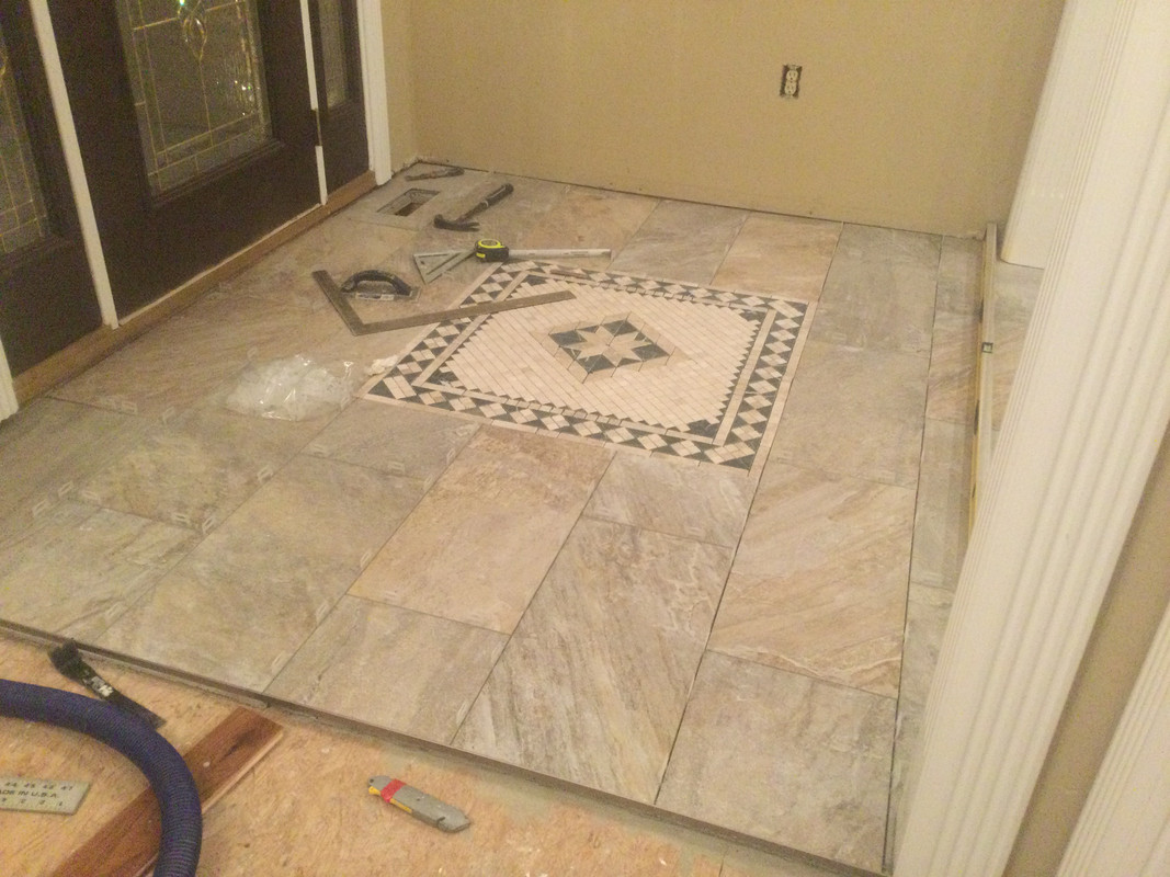

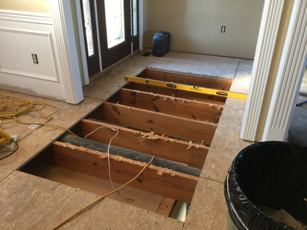

From this,
To this,
To this,
To this,
To this

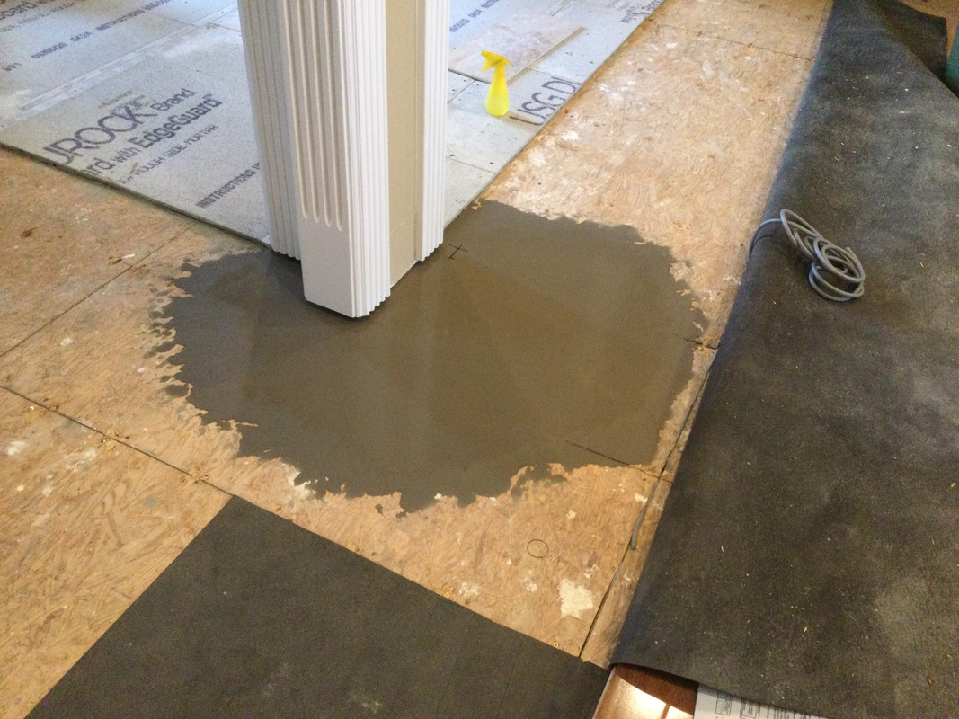

Still a couple low spots,
Getting closer,

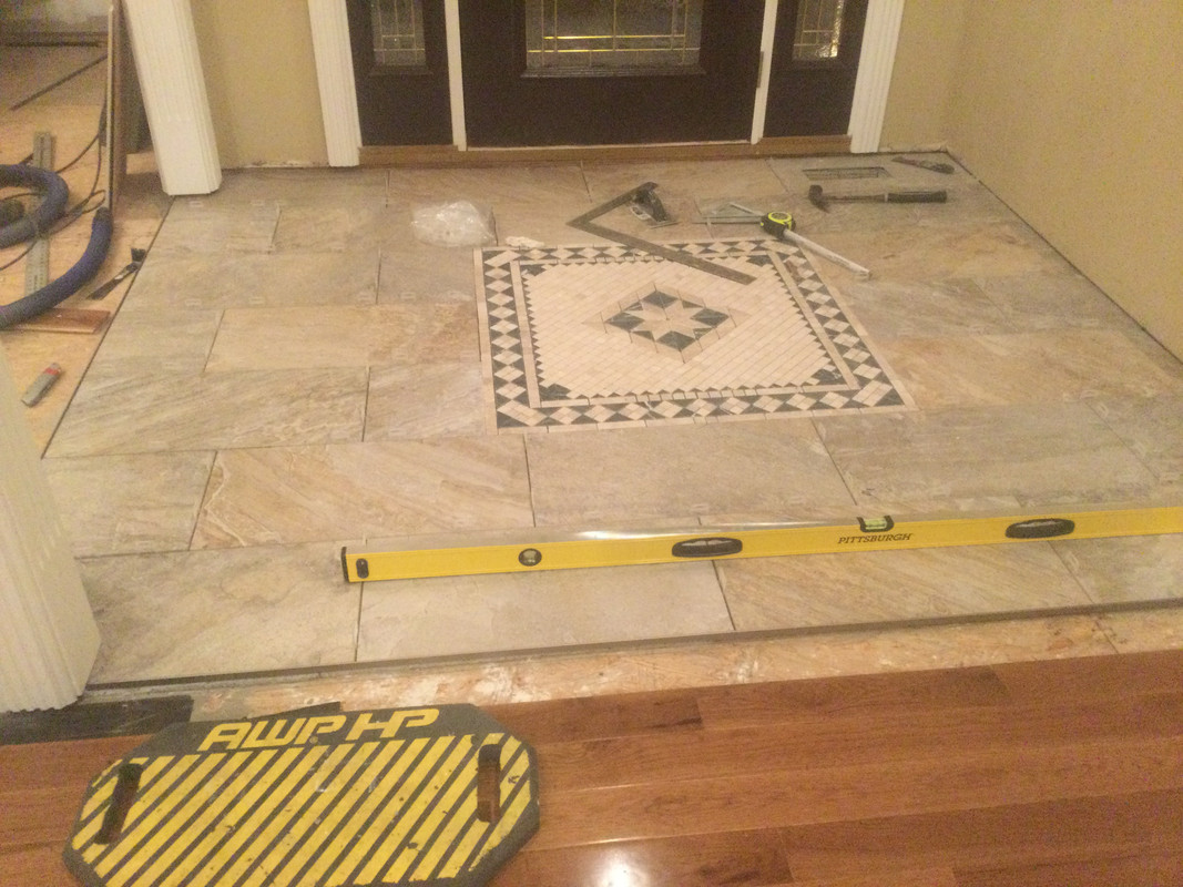

In the last two pics all the tile is cut and fitted but not mortared in. That was done today but will still need to be grouted. Grandsons coming tomorrow to spend the night and Monday with us. So grouting will wait. Then on to laying the hardwood to the now leveled dining room floor. At that point every square inch of flooring will have been replaced on the main floor. My knees will be so happy to move on to something else!

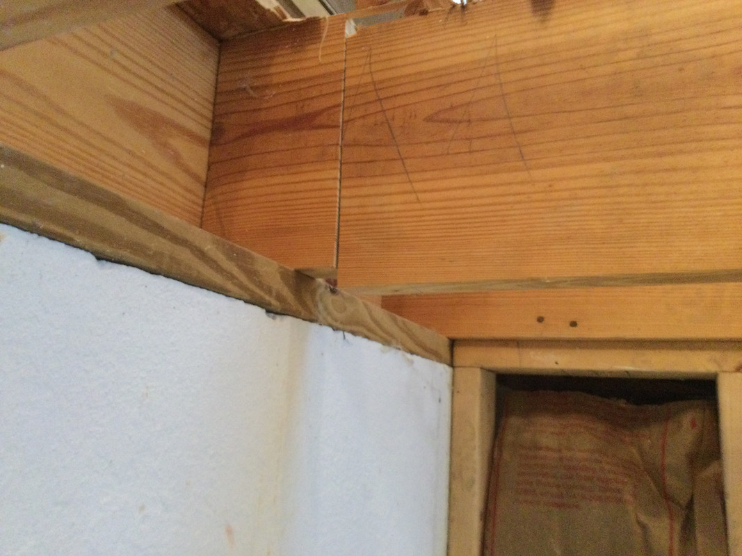

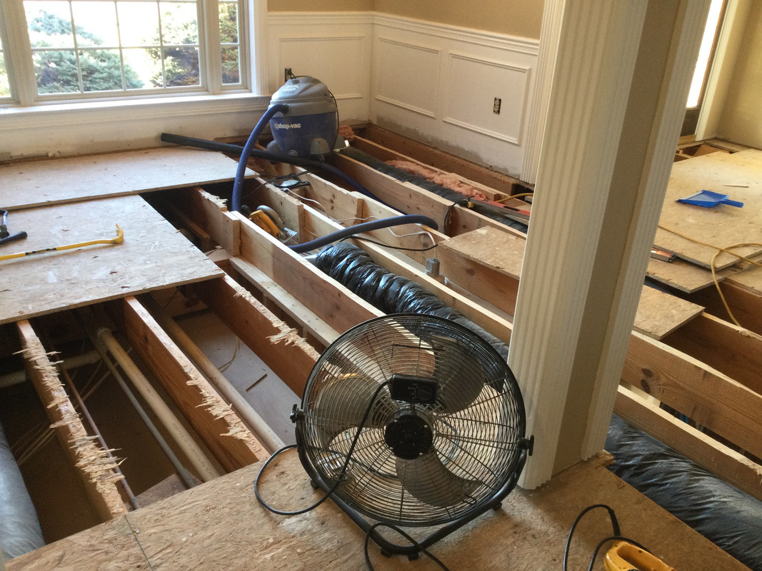

I agonized over this floor issue for over a year. It would have been much better if I had tackled it first thing, but I kept thinking I need to figure out why the floor was uneven and that would tell me how to rectify the problem. Nothing made sense to me so I finally had to start tearing things out. In the final analysis it was a series of stupid mistakes by the framing crew miscalculating the level of the front poured concrete foundation, the steel I beam running the  full length of the house and the framed back wall of the walk out basement, along with floor joist not being properly crowned, no extra joist under load bearing walls, ect.
No way could I have afforded to pay a contractor for all the work I have put into this house which I knew going in, just not the extent of what would have to be done.

« Reply #10 on: January 17, 2021, 07:16:22 AM »
Looks solid cooldude
Plenty of room between those beams for storage of....
Did you remember the trap door?

Hmm.  Good place to hide your AR15's from the upcoming ATF confiscaters.

No trap door, budget cuts due to upcoming economic implosion.
The design of this house offers multiple opportunities for that. cooldude

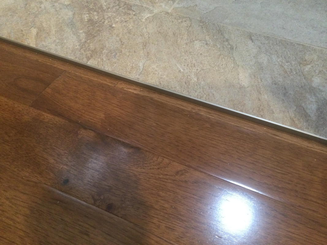

Unfortunately, what ChrisjCMA said is more correct  than I certainly would wish. I've spent 35 years in the tile/stone business as a manufacturer and commercial installation consultant, as well as heading up our national industry inspection program. There's a lot of good installers still out there, but they're starting to become a dying breed, as with real tradesmen in many of the tradional trades in other parts of the construction industry. A great many contractors would have left out some of the important steps you did here on floor  prep, making it difficult to get that beautiful tile layout to work properly. Looks great  cooldude
Did you manage to figure out your elevations for matching the hardwood up to the tile feature?

Unfortunately, what ChrisjCMA said is more correct  than I certainly would wish. I've spent 35 years in the tile/stone business as a manufacturer and commercial installation consultant, as well as heading up our national industry inspection program. There's good installers out there, but they're a dying breed, as with real tradesmen in many of the tradional trades in other parts of the construction industry. A great many contractors would have left out some of the important steps you did here on floor  prep, making it difficult to get that beautiful tile layout to work properly. Looks great  cooldude
My hardwood will end up being 1/4-3/8 “ below the tile level which is not ideal but believe it or not this will not be a high traffic area so as to be a trip hazard. I have a similar situation at both entrances to the kitchen which have been finished for months with no issues.
This is a doorway I just finished last week, between the hallway and utility room. The utility room tile was laid a year ago, the hardwood this past week.

There are also metal edge transition profiles which will handle that difference, but if it's not a concern to you then you're all good. Did you ever check out that vinyl transition underlay to help ease the hardwood up to the tile surface level for your entry? Either way, looks great... I'm enjoying following your project thread. Wish some of the contractors I deal with on jobs were as studious as you cooldude

Doesn’t the tile edge stand a big chance of getting chipped without a transition ?
msb
Posts: 2284
Agassiz, BC Canada
« Reply #18 on: January 17, 2021, 11:31:14 AM »
Has a metal edge profile on there.

I didn’t pursue the vinyl transition although I’m sure it could work magic for problem areas. My floors are far from perfect due to high and low joists ect. but it’s already a major improvement over how it started. The entire house was carpeted when I bought it (except for kitchen and baths) and it was hiding a lot of faults.
