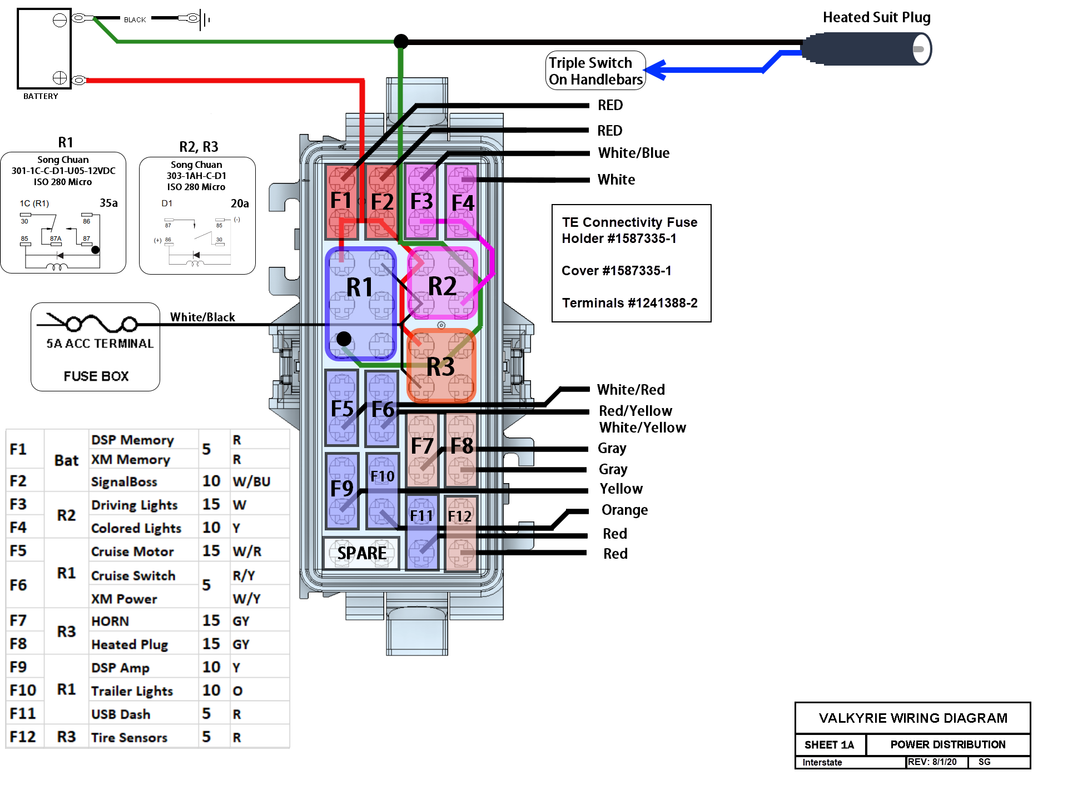

« Reply #4 on: January 24, 2021, 09:47:02 AM »
I created my own Power Block using the TE Connectivity to make a 12 circuit setup:
Here are the parts I used:
  • TE Connectivity Fuse Holder #1587335-1
  • Cover #1587335-1
  • Terminals #1241388-2
Uses Mini ATM fuses and relays (see diagram for part numbers)
This can be tucked in the compartment behind the battery if there is nothing else there.  I tucked this in the space in front of the battery and above the OEM relays.
Total cost was about $70 for parts and new wiring where needed.

« Reply #5 on: January 26, 2021, 07:23:47 AM »
I wish I could look at that schematic and see out of my crossed eyes.

« Reply #8 on: February 01, 2021, 11:22:04 AM »
Jersey,
Very nice design with integrated mini relays.
