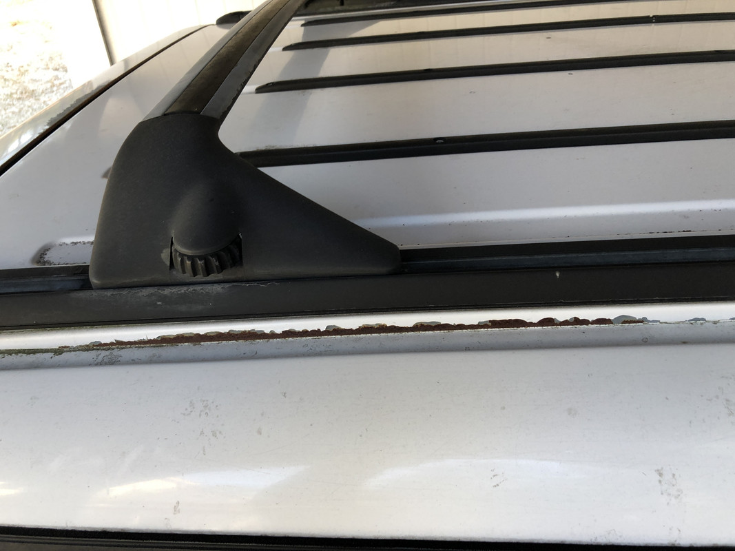

How the body look...any typical Ford rust?
Little or no rust, some pint deterioration (well there are areas where the shinny stuff is coming off but no rust)

I should have included a picture before.  Here is one from this morning.

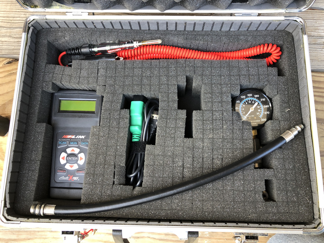

Posts: 12581
« Reply #29 on: February 08, 2021, 02:23:30 PM »
It says its an ODB II and I got the tool back out and set it up and did the scan.  Only thing that came back was P0133 O2 Sensor Circuit Slow Response Bank 1.  I will add the transmission change to the list.

Scan tool used.
The only real rust on the body.  Its the roof.

« Reply #30 on: February 08, 2021, 06:03:15 PM »
Some things to think about,
Coolant never goes bad, Yes it can get acid or loose its additive package but essentially ethylene glycol never goes bad. The additive packages can fall out of the coolant and clog the radiator. A additive such as water wetter will bring the additive package up to snuff help the cooling system and will not put additional additives in the system that can fall out and clog the radiator. Changing the fluid can and will depending on the antifreeze type used.
Rather than replacing the trans fluid and filter try a trans flush. Its much more complete and sometimes not necessary to replace the filter. Most times its not as hard on the trans either. By running the engine and allow a complete flush of the trans fluid with a possible synthetic fluid you have replaced all the trans fluid not just part. Most times unless there is a problem with the trans, the filter  will not be clogged. Most trans have 13 quarts of oil, the filter change only requires 3 or 4. By the flush you allow even the fluid in the converter to be changed with the latest fluid and not a partial change. Seems as long as done correctly there is less complications also from this.
Before going ahead and replacing the O2 sensor check for air leaks and a possible vacuum leak in the brake booster also. A lazy sensor could be nothing more than a bad one but sometimes its a problem with the extra air getting into the system and causing it not to cycle the way its supposed to. A bad or dirty injectors can cause this also but its more common to see an air leak rather than a bad injector. On the intake these engines have some vacuum lines in the back that have a rubber fitting that collapses.
If I am correct then they also have a plastic intake manifold with the Ford gaskets that seem to always flatten out and cause air leaks.
The other thing to know if I remember correctly they have a crankcase breather located under the intake manifold in the V of the engine in the rear part of the center V and it has a vacuum hose that is short and goes to the back of the intake manifold. This hose collapses and breaks and can cause many assorted problems in the running. It is hard to find and hard to see and I dont know if your truck has it but I am fairly certain it does. This has been a source of problems for this truck with both engines that it comes with.
In general these trucks just dont die, they are let go and suffer lack of maintenance but they do not die.
As for transmission fluid that is fully synthetic either RedLine or Mobil One synthetic ATF which is full synthetic should work, but check to make sure.
« Last Edit: February 08, 2021, 06:34:30 PM by Robert » Logged
