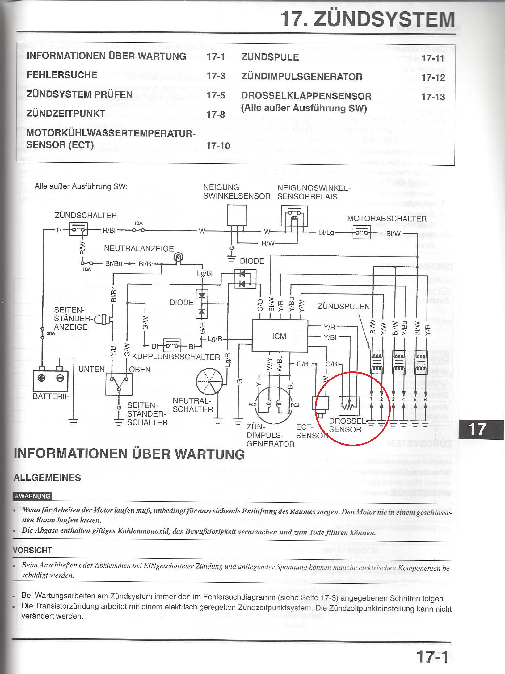

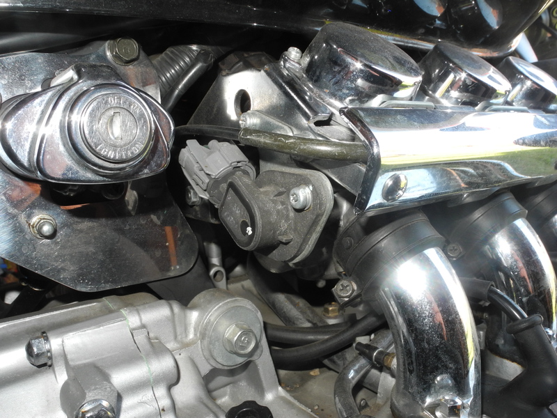

« Reply #8 on: February 12, 2021, 06:50:22 AM »
Do US-models Standard/Tourer have a throttle position sensor on carb bank?
European models do. This sensor has to be disconnected if a Interstate CDI is used.
The IS ICM does not need the input and gets hot if you keep it connected.
See European Standard schematics (red circle):
Sensor in place:
for benefits of an IS ICM in a Standard see post #2.
Shimmed Standard OEM needles or Interstate needles will improve effect of IS springs as written in post#7.
A Dyno Jet kit #1 if you can get one has the whole pack in one.
-mike-

Posts: 14897
« Reply #9 on: February 12, 2021, 01:33:01 PM »
Sensor in place:
-mike-
I don’t believe US bikes have this throttle position sensor
