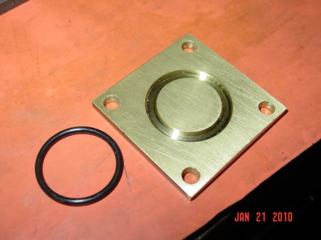

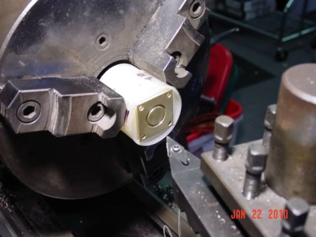

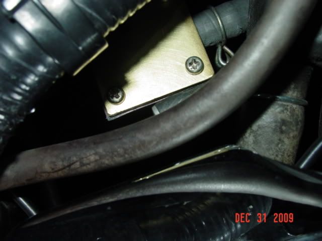

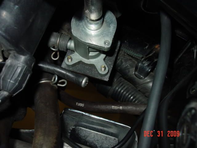

After rebuilding the petcock twice and this being the third failure, I decided to convert the petcock to manual and get rid of the vac. Made a simple plate out of some 1/8 inch brass and a fuel resistant gasket, tossed the diaphrams and vac housing, used the original screws and now no more fuel issues.  Just remember to manually turn off the fuel whenever stopped....and you can still use the original lever to switch from normal-off-reserve and don't have to reach way under the tank to find the pingle lever.  Hmmmm, just had the thought to cut a ring groove in the plate and use a o-ring instead of the gasket....like o-rings better...
http://i783.photobucket.com/albums/yy111/wncbridges/valk-pictures/DSC07219.jpg
http://i783.photobucket.com/albums/yy111/wncbridges/valk-pictures/DSC07218.jpg
Maybe you could put together a little kit and sell them here ....  cooldude

X Ring.....I saw your petcock pic's and understand you going for the pingle....it also makes one think twice about letting the weight of the tank with fuel rest  on the petcock while setting on the bench.
Does anyone know the construction of the Pingle, what makes it a more  secure shut off mechanism than the ball method of the OEM.  If reasonable care is taken to let the OEM detent properly, it ought to be reasonably reliable and like I said, I like the convenience of the rinky dink on-off-res lever.
Maybe I should whip up 5-10 of these with the o-ring, if nothing else it would be a easy fix for being caught out on a trip and the vac version went kaput.

Grinding a cutter to cleanly cut that little groove is a real pain in the azz!!!

Rio Wil
Posts: 1370
« Reply #35 on: January 22, 2010, 10:54:43 PM »
Hee Hee.....found another way to cut that pesky little groove....

« Reply #36 on: January 22, 2010, 10:58:05 PM »
Looks nicely done and like it will work. Is the O-ring groove smooth, so it won't destroy the O-ring?
