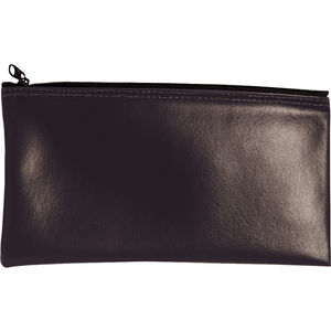

November 12, 2025, 11:41:35 AM *
Author Topic: Mystery Valkyrie Interstate Bracket  (Read 1321 times)
tarpshack
Posts: 18
Cincinnati, OH
« on: May 31, 2021, 06:16:38 AM »
I found this bracket in one of the the side bags of the new to me 99 Valkyrie Interstate. It was just loose not attached to anything. Does anyone know what this is for and where it goes?
« Last Edit: May 31, 2021, 06:24:03 AM by tarpshack » Logged
0leman
Posts: 2344
Klamath Falls, Or
« Reply #1 on: May 31, 2021, 07:23:22 AM »
Looks like the bracket to hold the driver's seat on.  Do you have aftermarket seats?
Veeten
Posts: 2
« Reply #2 on: May 31, 2021, 07:43:13 AM »
Looks like the tool pouch bracket for an interstate.
tarpshack
Posts: 18
Cincinnati, OH
« Reply #3 on: May 31, 2021, 07:51:06 AM »
Looks like the bracket to hold the driver's seat on.  Do you have aftermarket seats?
No. I have OEM seats.
Looks like the tool pouch bracket for an interstate.
Oh okay! Where does that go? Under the seat I assume? Any pictures would be helpful.
Ramie
Posts: 1318
2001 I/S St. Michael MN
« Reply #4 on: May 31, 2021, 09:11:38 AM »
Not sure where my bracket started out but it's in my left saddlebag bolted to the bottom holding the tools in place.
Veeten
Posts: 2
« Reply #5 on: May 31, 2021, 09:41:07 AM »
Yep, left saddlebag. If you don't want it, mine's missing!  Grin
Jims99
Posts: 822
Ormond Beach Fl.
« Reply #6 on: June 01, 2021, 05:03:25 AM »
Mine’s gone too. I had no idea those existed. My tools are under the seat like the tourer.
99 tourer
00 interstate
97 standard
91 wing
78 trail 70
Factor
Posts: 37
Clayton, NC
« Reply #7 on: June 01, 2021, 05:12:46 AM »
Left saddlebag, rear bottom mounting bolt, positioned on outside edge of bag.
Steve
VRCC# 38798
'75 Hoda GL1000 Project
'83 GL1100 MonkeyWing
'70 Suzuki T500 Titan
'99 Valkyrie Tourer
'64 MGB
'89 Isuzu Trooper 3.4L
IBA #58082
All my stuff is old. It makes me feel young.
SCain
Posts: 627
Rio Rancho, NM
« Reply #8 on: June 01, 2021, 06:38:04 AM »
Its the holder for the Honda Tool bag, it mounts in the left saddle bag.
It requires a rubber strap similar to the battery box hold down strap.
Steve
tarpshack
Posts: 18
Cincinnati, OH
« Reply #9 on: June 01, 2021, 09:54:43 AM »
Its the holder for the Honda Tool bag, it mounts in the left saddle bag.
It requires a rubber strap similar to the battery box hold down strap.
Okay. Looks like the bracket was floating around in the saddlebag because the bolt sheered. No sign of the rubber strap though.
Posts: 30836
« Reply #10 on: June 01, 2021, 09:59:35 AM »
I'm glad I rediscovered what that was.   cooldude
Years ago, I created a larger toolbag (zipper case) with my own tools, with the Honda tools thrown in.
I've had that bracket (I must have taken off) sitting up on a shelf for 10 years, and no idea what it was.
Unfortunately, there must be a dozen or so widgets, brackets and other parts there with it, and I don't know what any of them are (but I keep them in case I need them).  Grin
« Last Edit: June 01, 2021, 10:05:12 AM by Jess from VA » Logged
