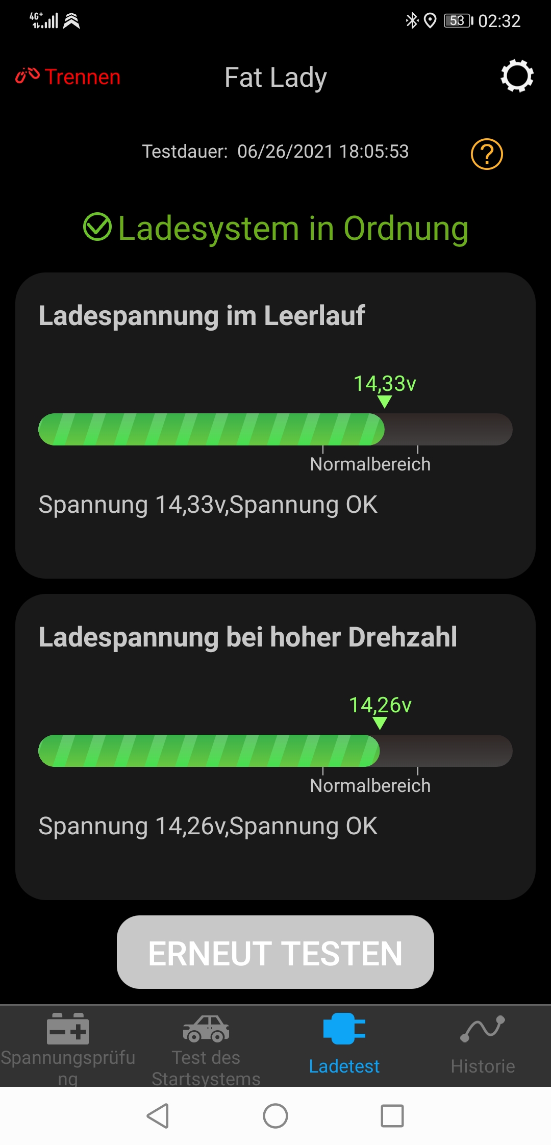

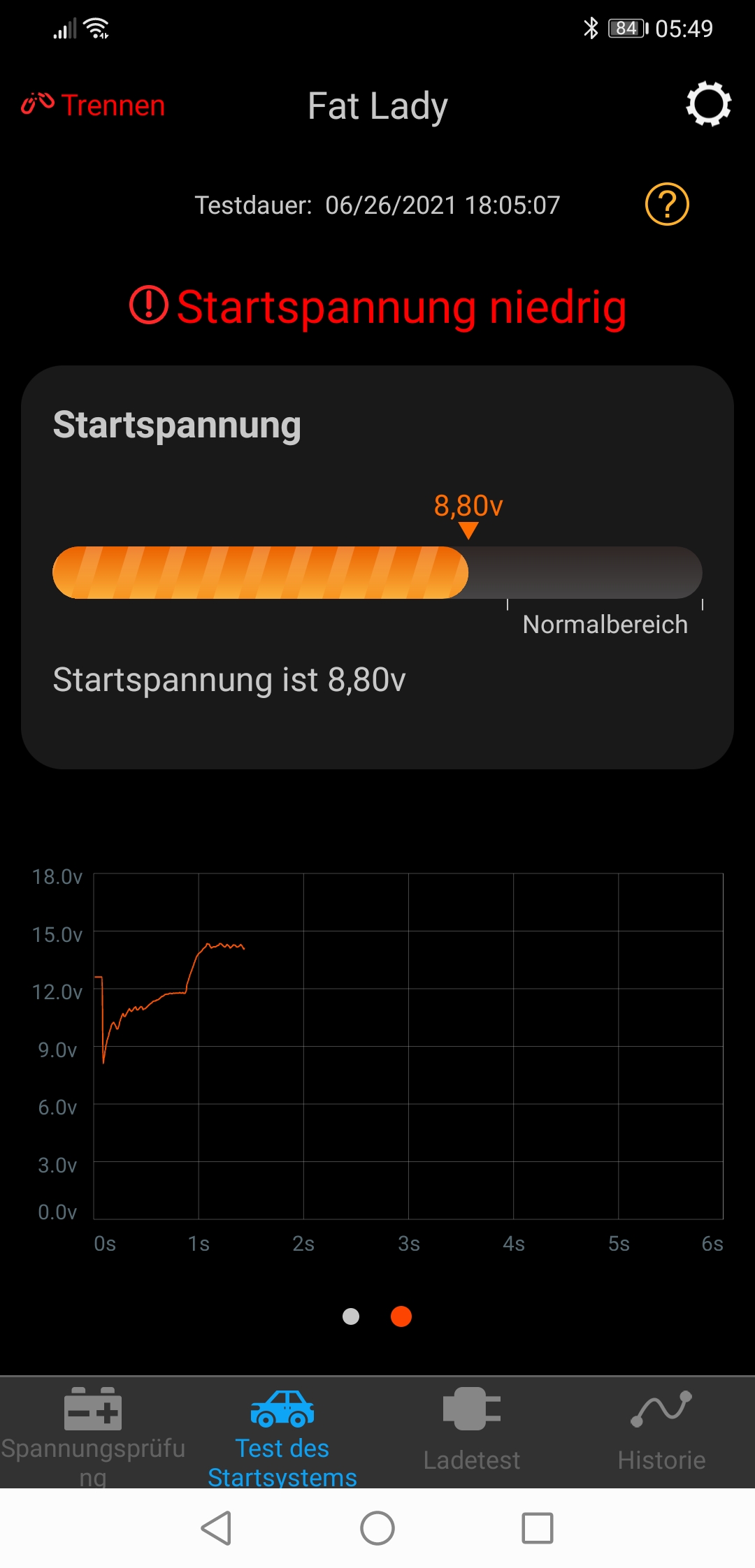

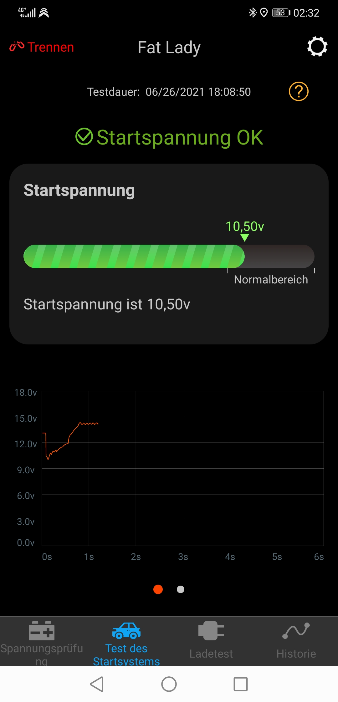

« Reply #8 on: June 27, 2021, 09:14:19 PM »
I replaced the battery last year - for the peace of mind after I discovered that my Fat Lady was still running on its first battery (Yuasa manufactured 1999).
This old battery still is able to start the engine (and is kept for emergencies or to help one out).
Regardless of battery manufacturer I'd recommend installing a battery monitor that logs every start and can give you an indication of battery health and early warning of alternator fail before you get stranded.
See Screenshots (German app setup).
A) 22 year old Yuasa at startup
B) startup of 1 year old battery
C) Alternator testing (voltage idling and at 2K rpm)
-mike-

« Reply #9 on: June 28, 2021, 05:06:07 AM »
I would check the alternator while at idle and at higher rpm’s to make sure it’s not overcharging. I had a bike that would put out almost 17v at higher rpms and killed my battery. Tested fine at lower rpm’s.

« Reply #11 on: June 28, 2021, 05:54:40 AM »
Good point. You can choose the running rpm at altenator test as high as you want  (over 2K was just the recommendation by the app)
Any possible overcharge is saved by the system in permanent (24/7) or in trip log, which are automatically transmitted once a day to the cell phone when coming within Bluetooth range of the bike.
15 bucks well invested in my opinion.
-mike-
