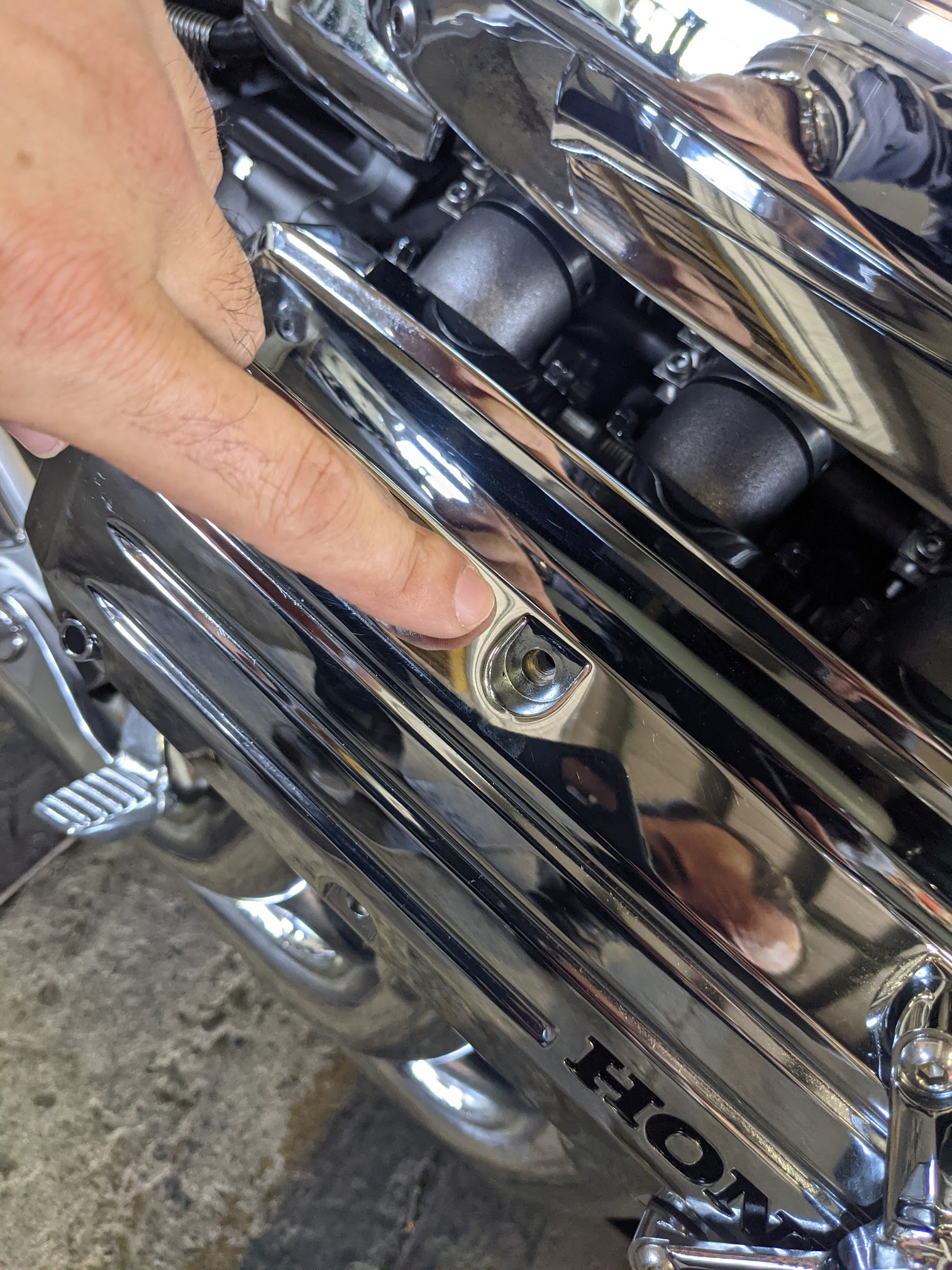

I'm unsure if this should go on General or 1800 specific forum. In any case, here it goes...
Today I went to check a Rune for sale near home. The bike had low miles (<10K), no rusted parts a few dings in the gas tank but nothing else I noticed.

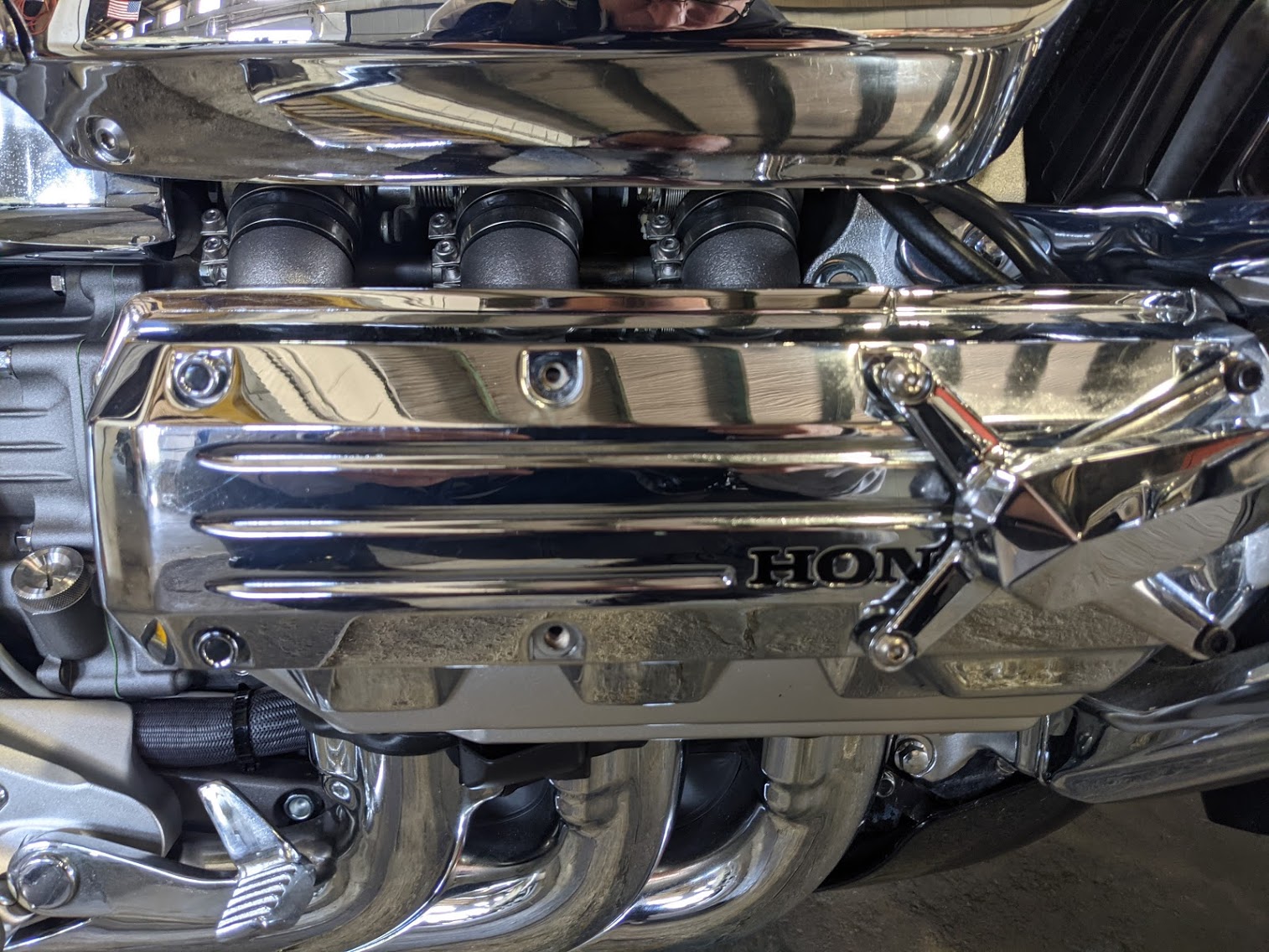

What is the main concern is that it has 2 broken bolt heads in the valves cover (please see photos below).
Is that something easy to fix or is it a main blocker (pun intended), requiring drilling a bolt in the engine block, etc?
The asking price is 16K + fees.

Photos:

Close in:

« Reply #4 on: July 03, 2021, 10:48:50 PM »
From the pic it doesn’t look broken. But missing.

« Reply #9 on: July 05, 2021, 06:29:34 AM »
I dont think it has any thing it actually holds that is important. You could just take a short 10MM bolt screw it in and put a chrome cap on it. It would keep the look without any real work.
