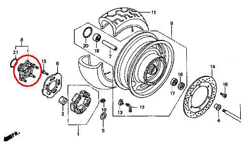

I read over Sodbuster's post that Ramie linked. Instead of using Bel-Ray Assy Lube for the driven flange, I used plain waterproof Bel-Ray. I did mix in a little Honda moly paste to get some moly. This isn't always recommended as the base material might conflict, or something like that.
Bel-Ray Assy Lube isn't manufactured anymore as far as I can find. Optionally, Guard Dog 570 (moly paste) also isn't available since Guard Dog ceased doing business in 2016, here.
Apparently, T. S. Moly Lubricants is about the only popular source for moly paste.
