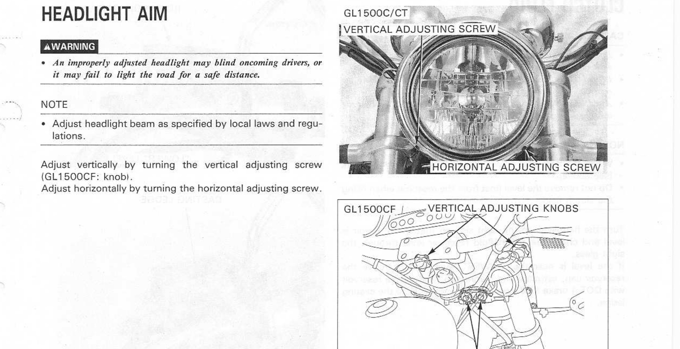

« Reply #3 on: July 25, 2021, 11:00:23 AM »
I keep seeing that there are supposed to be two 8mm adjusters on the back side of the bucket
This picture makes me think you're talking about Interstate adjusters....

« Reply #4 on: July 25, 2021, 11:42:53 AM »
1997 standard
Your adjustment screws are in the front of the Chrome ring around the headlight sort of on the sides at five and seven o’clock. One is for left/right and one is for up/down. Stick a phillips screwdriver in the hole and find the screw. A flashlight may help at first till you know where you’re aiming.

« Reply #6 on: July 25, 2021, 12:17:36 PM »
There may be an issue with the mechanism.
No matter which way I turn it or how much I turn the screws, I get no movement.
But thank you all for your replies!

« Reply #8 on: July 25, 2021, 05:57:38 PM »
That is a possibility.  if someone turned it all the way counter clockwise far enough the screw will come out of the nut or housing.  I don't recall which set up the Valkyrie has.  In either  case  you will need to remove the chrome ring and put the screw back in the correct position.
