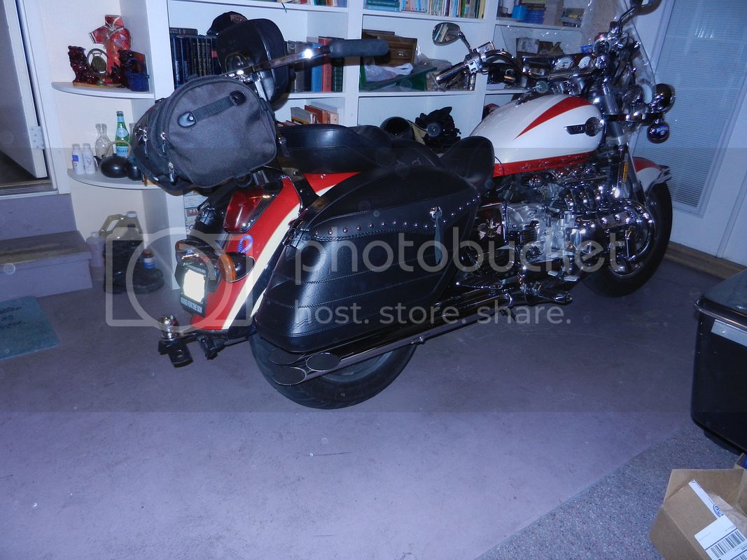

 So I finally ordered aftermarket hard bags. Of course there was no option for Valkyrie specific mounting. They come with universal brackets. My first issue is I go back and forth from stock exhaust to Cobra 6 into 6. My question is which pipes set higher on the bike ? I want to make sure I have the clearance for either. 2nd question is minimum clearance between the pipe and bag?

I mounted these bags with Cobra pipes installed. Works fine like this for both.
Sorry I couldn’t find the better side pic of the bags with Cobra pipes. I used a 2x4 (thin side) between the bag and the pipes to set the spacing

« Reply #2 on: February 08, 2022, 06:14:03 AM »
  Thanks Chris. It looks like there is less clearance with the Cobra. I like the 2x4 idea, simple, keeps them level and even.
Posts: 14802
« Reply #3 on: February 08, 2022, 06:15:42 AM »
The clearance is just about the same with either. It’s the camera angle
