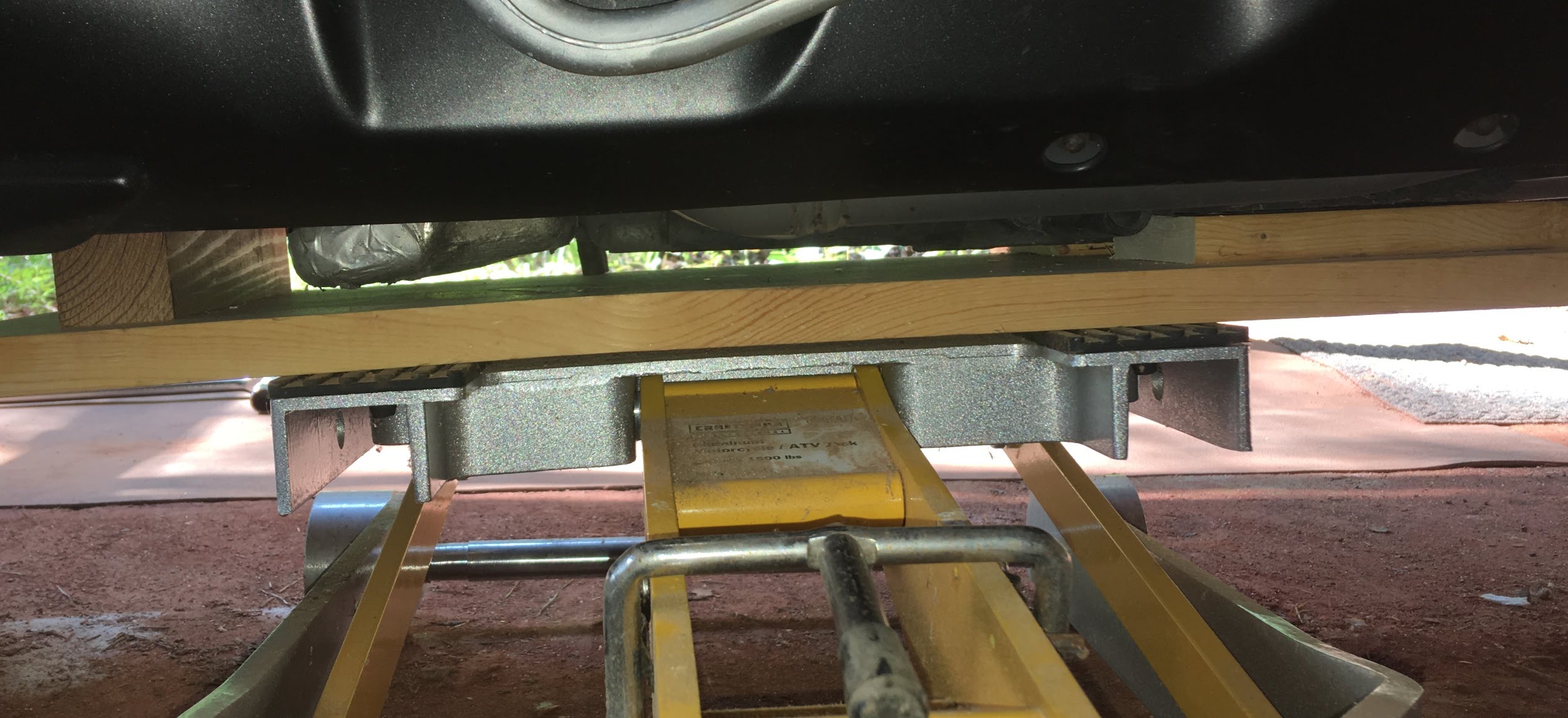

I hate how high you have to lift the new Valkyrie to get the wheel out.
I take the rear fender section off my old Valkyrie. I've removed the rear
fender section and sub-frame parts from the new Valkyrie it is a lot of
trouble especially after you've added Corbin bags and their brackets.

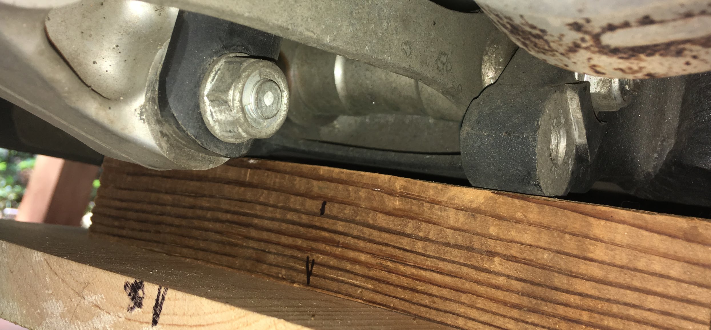

I made a couple of wooden adapters. The first one was wobbly. It touched
the bike at the shock link. The next one, much much better, touches the
bike at the lugs where a center stand would be on a regular goldwing.
The bottom of the engine doesn't have a flat place, so it is
supported by two blocks.
The sears aluminum lift is a decent lift - except you need to take
GREAT CARE to keep your bike from lowering like a sack of concrete
someone threw off the roof...

The problem is that if I lay it on my jack I can't then slide everything under the bike.
I made the main part of mine out of a studly high-grade 1-by instead of a 2-by to get around that...
