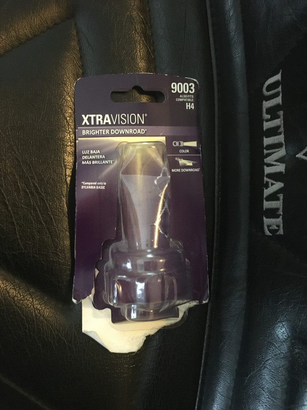

I use these. Available stop Walmart or auto parts places.
Almost as bright as the silver star but lasts much longer. Plug and play. Easy.

Thanks gentlemen.  I shall visit Wally World tomorrow.

Its funny, every Walmart within 30 miles has one except, except the one in my town (or the town nearby).   Ahh will check the auto supply places.
Advanced Auto has one.  Its $21 vs the $13 at Wally World.      Ahhh the way things work out.

Be very careful to NOT touch the glass portion of the bulb while handling and installing.

I you touch the glass, or even if you don’t, clean with alcohol and a Kleenex before installing.
