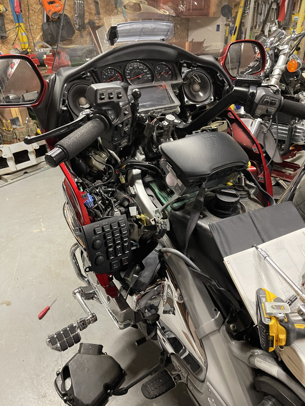

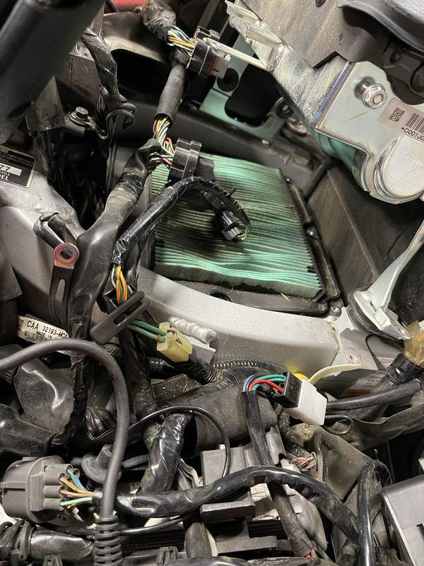

To get down to the air box on my Wing. Having that airbag is a b!§¥£. I didn’t throw any tools or swear but I wanted to a couple of times. Last I heard dealers get $450.00 for changing an air filter. So not a bad day for me even though it is still apart. With it tore down this far, thinking about some headlight upgrades, I have a speed healer to install, digital voltmeter with USB ports coming tomorrow, lots of cleaning to do.
At least it wasn’t as dirty as I feared.

I thought having the airbag was kool and it couldn’t hurt, I believe I would pass on the airbag in the future. Lots of warnings in the owners manual about not disconnecting anything connected to the airbag.
I changed my wing's air filter in June of 2019 (so it says in the maintenance log) and I need to change it again.  I have been putting about 40,000 plus miles on each filter.
Use Fred's discs.   Just reviewed the process yesterday to refresh my memory.  It's a bit of work but I was so very pleased when I did if the first time and everything worked when I got done.   cooldude
I have Fred’s disc’s and I watched them this morning but it was not an airbag model so some significant differences.
looks brand new. the 12k miles change out is worst case construction sites, dirt roads, etc. miles to change out is a poor gauge to use, air restriction is the correct way to determine change out. 12k like the 3k oil change pushed on vehicles is a lie to sell more products and keep their service depts active.
your air filter will flow the same as a brand new one out of the box. changing too soon actually allows more dirt in over the lifetime of a filter
Servicing too frequently prevents the air filter from ever reaching its peak efficiency. In addition, the risk of engine damage increases every time the air filter is removed from the air cleaner housing.
Air filter service life should be determined by measuring airflow restriction – not by visual inspection alone.
