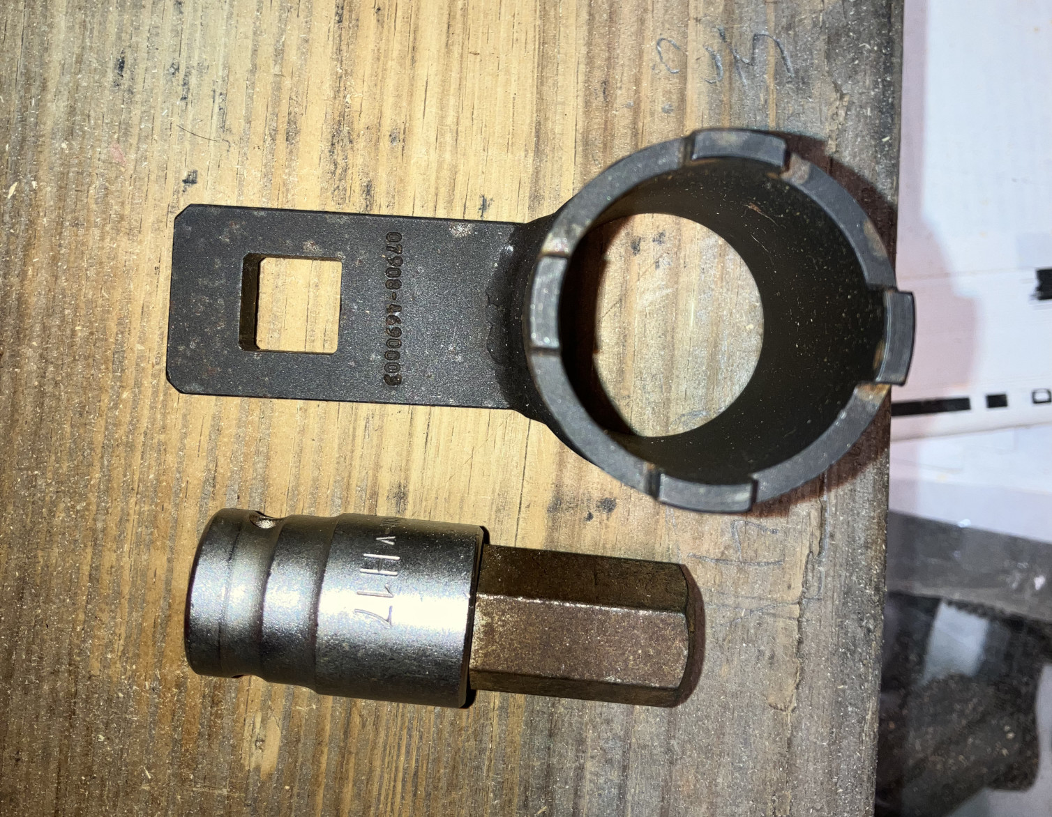

The service manual says to use special tool to renmove the swing arm nuts. Can a general, non special tool get the job done.

question? why are u removing the swing arm? the bearings are overkill, barely move and don't need maintenance.
yes u need the tool to re-torque the nuts.

Quote from: ckahler on February 11, 2023, 04:31:32 PM
This is what you'll need......
https://www.amazon.com/gp/product/B088M5SNJN/ref=ppx_yo_dt_b_asin_title_o00_s00?ie=UTF8&psc=1
https://www.amazon.com/gp/product/B0B4DF9J39/ref=ppx_yo_dt_b_asin_title_o01_s00?ie=UTF8&psc=1

I bought some Honda tools ten or twelve years ago, and I've had my swingarm off before.
With the right tools, it is a breeze to take the swingarm off. I assume those tools
Baldo posted are appropriate, and the price sure is right
The Honda tool specified in the manual has an offset lever arm, that's what
I have...

I made one and my old friend Grumpy welded it together for me. Only used it once when rebuilding a Valk with fire damage.

I made one couple weeks ago from a 30mm 1/2 in drive socket and some cutting with angle grinder.

I've purchased a lot of specialty Honda mechanic's tools from eBay over the years. Look in the Service Manual for what you need, set up a search and eventually they'll come up.

Quote from: psckam on February 13, 2023, 03:03:56 PM
Did the same thing to remove the swing arm on an '89 Honda HAwk GT for a friend...
Old crappy socket was finally useful for something.
