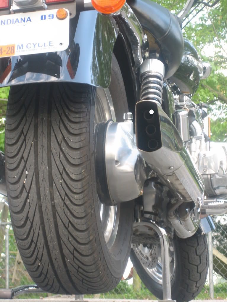

I have the Dunlop K491 Elite II MT90HB17 mounted on the front and a 205/60HR-16 General Altimax HP mounted on the rear.  I rode 1300 miles with the rear car tire and OEM front tire before changing to the K491.  When I changed I immediately noticed that the counter steer from the car tire was eliminated.  However, I also noticed instability at speeds over about 85 MPH.  I think that at least two other riders with similar combinations had the same results.  I also know others who had no high speed problems.
I attribute both changes to the fact that the MT90HB17 (I believe the same dimensions as a 130/90-17) is narrower than the OEM tire, but I am by no means a tire expert.
I simple throw this out as something that I experienced.  I neither recommend nor discourage my combination or any other combination.

« Reply #69 on: February 13, 2010, 06:57:14 AM »
 Roll Eyes
http://vrcc.photostash.com/vrcc_29994/201_2583.jpg
