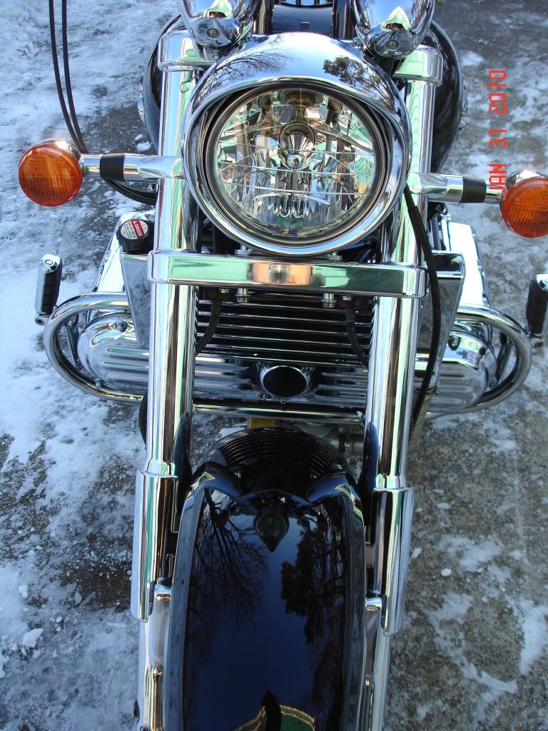

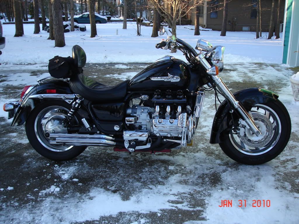

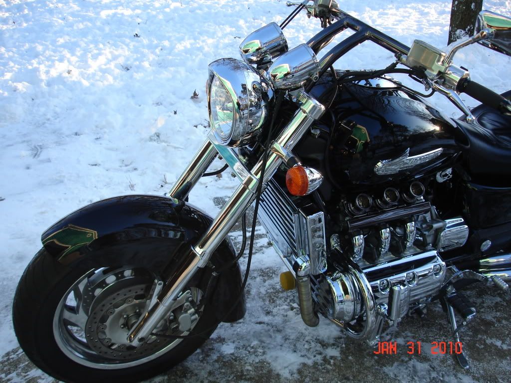

« Reply #7 on: February 02, 2010, 08:49:31 AM »
I got the 6 degree kit from Daryl at XF6 here.  Awesome guy to work with.  I cant say enough good things.
http://www.xf6-custom.com/partpages/tripletree.html
I just finishing installing the trees but have not a chance to ride it yet.  We got 8 inches of snow the day I finished it.  It sure does look good though.  I polished my fork tubes while I had the bike apart also.  I'll have some better pictures once the weather clears.

I am very interested in any noticeable changes in handling with the raked trees. The polished down tubes are excellent. Please keep us posted.
