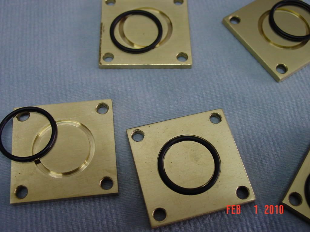

I made a few extra o-ring type plates to eliminate the diaphragm leaking issue.

« Reply #1 on: February 01, 2010, 05:04:21 PM »
you got a photo of it mounted ??

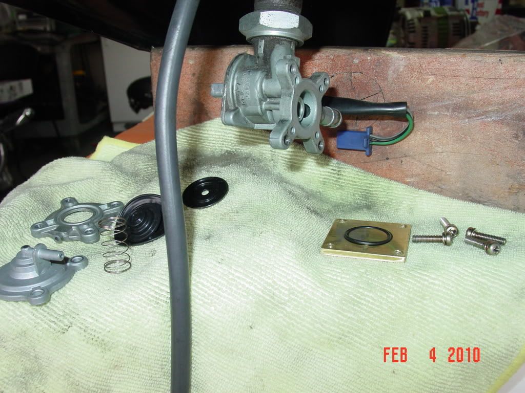

« Reply #5 on: February 01, 2010, 07:12:10 PM »
Yes, all the bits that make up the vacuum function are discarded and the vac hose from the #6 cylinder is plugged. The square plate is made of brass and the o-ring is nitrile. The fuel flow is now controlled only by the res-off-on switch.

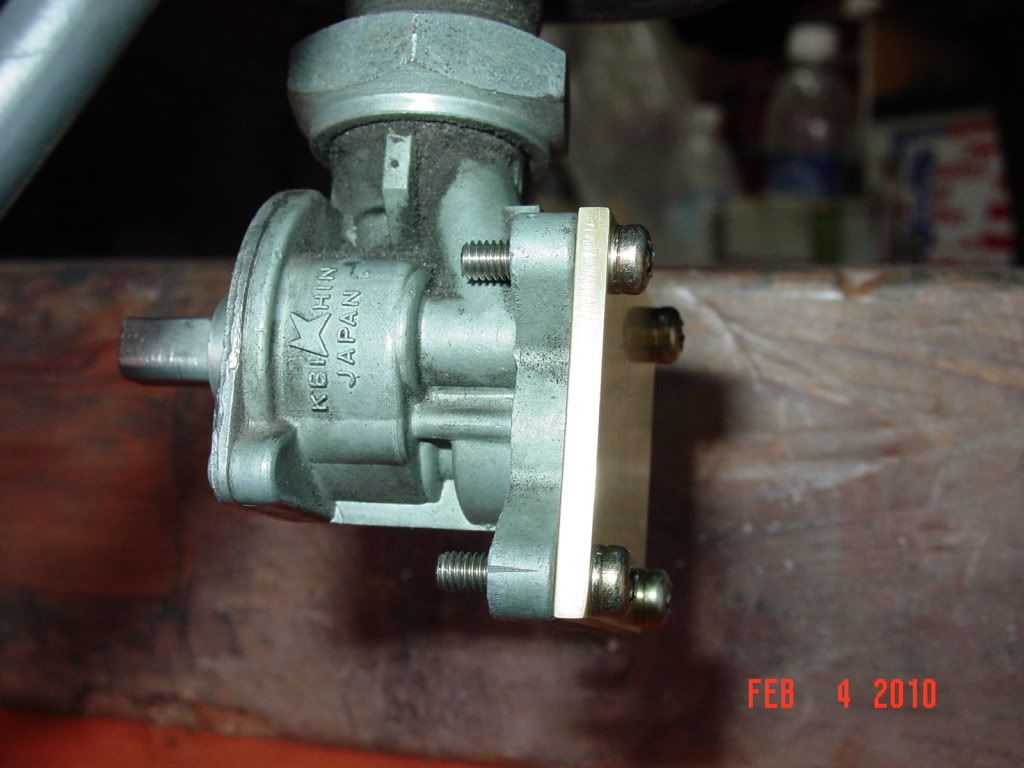

« Reply #12 on: February 04, 2010, 07:04:14 PM »
Here are a couple of pic's showing the bits and pieces  replaced by the plate and o-ring and a final pic of just the plate installed and ready to go....  Guess I could have cleaned the petcock first... Undecided
