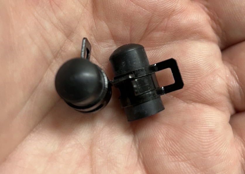

I really like the caps supplied when purchasing my Digisync…they seem heavy duty and even better than the originals on my bike.
