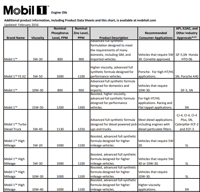

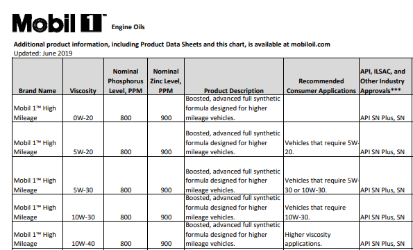

It's been many years since they sold Mobil 1 with colored caps. 15W-50 was red, 10W-30 was green, and I think 10W-40 was black. Maybe they stopped the practice because they make Mobil 1 in so many weights these days. There wouldn't be enough colors in a pride flag for all the varieties.
I downloaded Mobil 1 spec sheets for a few years. I still have the PDFs from 2016, 2018, and 2019, but can't find a current one. These sheets list the zinc and phosphorus levels for each grade. For some weights, the levels dropped over that 3 year period. For instance, 4 weights of high mileage M1 were reduced from 1000/1100 (ppm of phos/zinc) to 800/900. Most weights, including the 15W-50 auto and both MC oils did not change.
Regarding the issue of phosphorus damaging catalytic converters, I read some posts by an automotive engineer (GM I think) discussing tests performed back when the EPA was only proposing reductions in ZDDP levels. They found that in engines without serious oil consumption problems, so little contamination made it to the exhaust that there was no damage to the cats. However, the oil manufacturers had already developed formulas using more calcium and less ZDDP so there was little opposition to the rule change.
These days, when I switch oil or filter brands, I run an oil analysis to make sure there were no adverse effects. I switched to the Wal Mart Super Tech filters and found that they worked just as well as the Bosch I had been using. Now I'm trying Rotella T4 (conventional) 15W-40 in both Valkyries and will test them both at the next oil change. I had been running Mobil 1 15W-50 automotive oil.

I'll go online and get them. For comparison, here are screenshots from 2016 and 2019 showing the reduction in phos/zinc in their high mileage oils. The 2016 sheet also shows levels for the 15W-50.

That's interesting. The MC oils and 15W-50 didn't change, but for nearly all the automotive oils the levels dropped even more.
