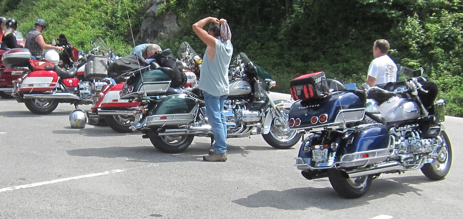

You can see my large sized (and full I'm sure) Givi bag attached to my rear carrier in
this picture on the way to the Wisconsin Inzane ten years ago or so.
Scott, one of the VRCC runners back then, told me he had seen
a rear carrier break from too much weight. I think they're stout
enough if you don't get too crazy...

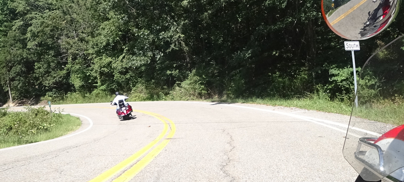

We were chasing Smokin' Joe to the meet-in-the-middle ride
a few years ago. We were on a curvy road in the mountains  Wink ...
All of a sudden there was this tight off-camber reducing-radius
downhill right-hander. It caused the rider in front of me to
blow the turn so badly I looked for it in my pictures later...
I just pressed as hard as it took on my Valkyrie's handlebar
and expected it to stick and not drag.
Do you hitch-carrier guys have to worry about dragging?
No, I have ridden the Blue Ridge and many other roads with much tighter curves and chased down other riders. The key is to use the right designed hitch and carrier. One with little or no side to side movement. What ever is mounted on your motorcycle should upset the suspension as little as possible.
