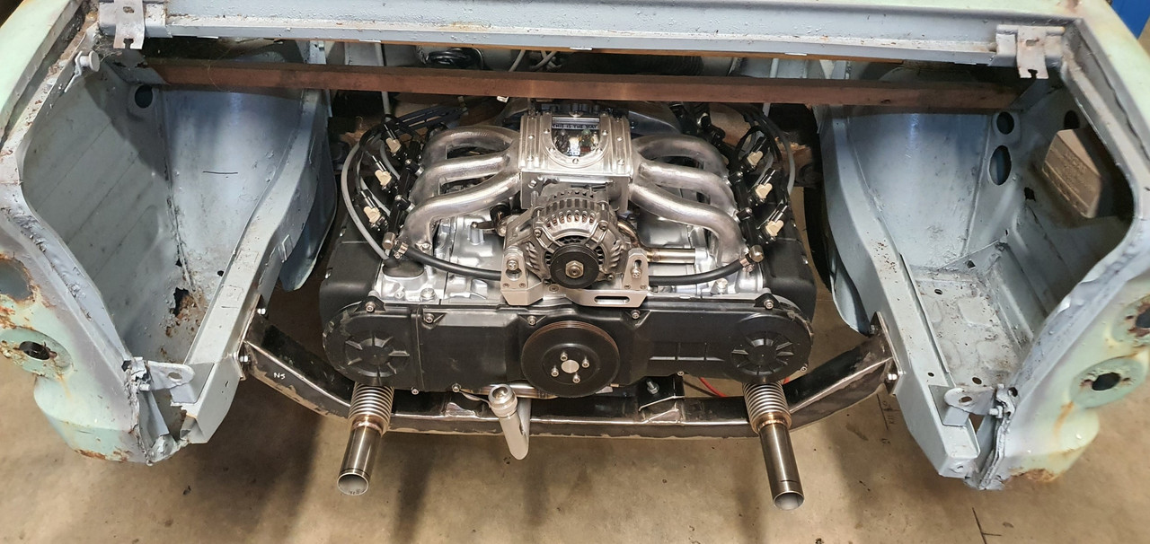

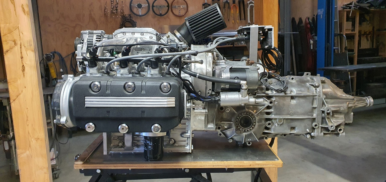

This is a Goldwing 1500 engine modified by a homegrown mechanic in New Zealand.
It’s going into this.
He cut the bottom off the crankcase to eliminate the transmission! The amount of machining has been incredible. It will be fuel injected with him machining all the bits for that to work.
This is the guy in his home shop
The engine being test fit is a parts car to check for clearances
Just another look. The project has been ongoing for two years between working on customers cars. He did an amazing amount of body work on the car itself.

He’s made more progress with fine tuning the electronics. He has now tore apart the Subaru transmission to make changes because it will turning opposite its normal rotation. YouTube video is only 12 seconds but first time he had really got into the throttle.
